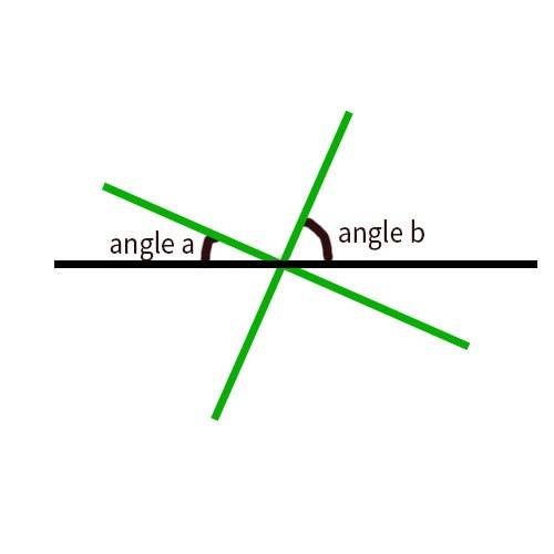

Sorry for the confusing tittle but I could not explain it better. Here is what I am trying to ask:
When you have 2 axis(x and y) such as the image below, the sum of the two angles, a and b will always be equal to 90 degrees.
a + b = 90degrees

I have no idea what you're asking. Your code is not enlightening, since it's not clear what the code is supposed to be doing.
Going back to your drawing, are you assuming that the two green lines are perpendicular? If so, then the angles a and b will add to 90°. However, if the two green lines aren't perpendicular, then a and b don't add to 90°.

Sorry for the confusion... Long story short, I wanted to know if the same rule for 2 perpendicular lines applies for 3 perpendicular lines.
For 2 perpendicular lines(x and y):
angle between the first green line and the black line + angle between the second green line and the black line = 90 degrees no matter what
so I was wondering if there was 3 perpendicular lines(x y and z) does the same rule apply?
angle between the first green line and the black line + angle between the second green line and the black line + angle between the third green line and the black line = 90 degrees?

Isn't this last condition always wrong if the black line is in the direction of one of the other lines? The sum should be 180 degrees then.

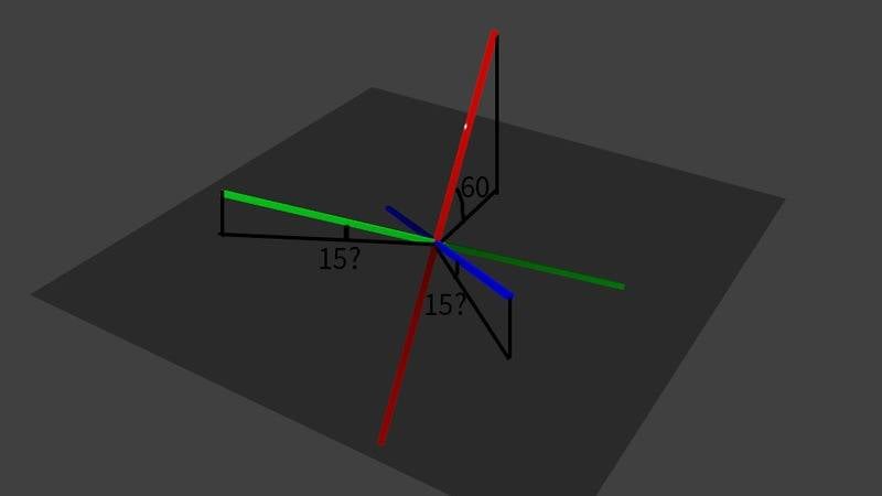

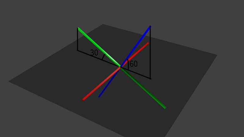

ADDITIONAL EXPLANATION WITH PICTURES
0(red axis)+0(green axis)+90(blue axis) =90
0+30+60 = 90
So these two are rotated only on the red axis, which means that it is only 2 dimensional. So when you introduce rotation on other axis will the sum of these angle remain 90 degrees such on the image below?
You should be able to solve this problem with a general roll-pitch-yaw rotation matrix and calculation of the angles between the rotated x,y,z-unit vectors and the plane shown in your picture.

This was for rotation about one axis. If someone else wants to try rotation about two axes, feel free.
Ok, so much about taking a nap!
Just looking at the general matrix above shows that even or the general case (rotation about three axes) the rotated unit vectors are
##e'_x = \begin{pmatrix} \dots\\\dots\\ -\sin \Theta\end{pmatrix}##.
##e'_y = \begin{pmatrix} \dots\\ \dots \\ \sin \Phi \cos \Theta \end{pmatrix}##
##e'_z = \begin{pmatrix} \dots\\ \dots\\ \cos \Phi \cos \Theta\end{pmatrix}##
With the same argumentation as above we have now
##\sin\varphi_x=-\sin\Theta##,
##\sin\varphi_y=\sin\Phi\cos\Theta##,
##\sin\varphi_z=\cos\Phi\cos\Theta##.
Lets use some identities to see if the sum of the angles can be bigger than ##90^\circ##.
##\cos \Theta \cos \Phi = {{\cos(\Theta - \Phi) + \cos(\Theta + \Phi)} \over 2}##.
##\sin \Theta \cos \Phi = {{\sin(\Theta + \Phi) + \sin(\Theta - \Phi)} \over 2}##.
Since all angles are positive,
##\varphi_x=\Theta##,
##\varphi_y=\arcsin(\sin\Phi\cos(\Theta))=\arcsin({{\cos(\Theta - \Phi) + \cos(\Theta + \Phi)} \over 2})##
##\varphi_z=\arcsin(\cos(\Phi)\cos(\Theta))=\arcsin( {{\sin(\Theta + \Phi) + \sin(\Theta - \Phi)} \over 2})##
Now let's just choose ##\Theta=\Phi=45^\circ## to get
##\varphi_x=45^\circ##
##\varphi_y=\arcsin(\sin\Phi\cos(\Theta))=\arcsin({{\cos(0) + \cos(90^\circ)} \over 2})=\arcsin(\frac{1}{2})=30^\circ##
##\varphi_z=\arcsin(\cos(\Phi)\cos(\Theta))=\arcsin( {{\sin(90^\circ) + \sin(0)} \over 2})=\arcsin(\frac{1}{2})=30^\circ##
Summation: ##\varphi_x+\varphi_y+\varphi_z=105^\circ \neq 90^\circ##- Seems to fit with your observation.

Okay thank you! So i guess my guess was pretty off :'(...
So the reason I was asking if the sum of these angles was 90 degrees is because I wanted to express these angles in percentages.
If only one axis is rotated, the sum is always 90 degrees so all I have to do is the angle*100/90 and I would get the percentage. However this does not work when all axis are rotated. It seems like the maximum sum of the angles are arcsin(3^-1/2)*3 or about 105.793 degrees.
When more than one axis is rotated, the denominator has to be a number between 105.793 and 90 degrees. And I don't think this method will work.
Are there any alternatives?
Although it may seem pointless, I really want to be able to show these angles in percentages to calculated the weighted average of the anglesThank you :D
Also thank you DarthMatter for the solvings... It seems that I need to study a lot more math
Well, if it seems pointless, why do it? I guess you could just divide by 105.793 degrees for a simple solution. If you want a more sophisticated solution, you could calculate ##\varphi_x + \varphi_y + \varphi_z## and divide the single angles by it. I am not sure what that number means geometrically though.
