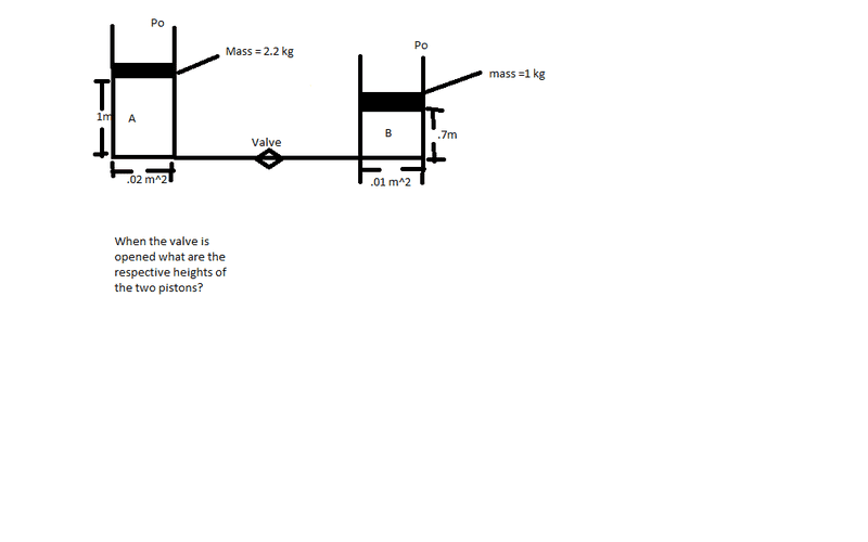

Two tanks filled with oil with density 860 kg/m3 are connected by a valve. Tank A has piston with 2.2 kg mass, cross sectional area of .02 m^3 and is suspended 1 m from the base of the tank. Tank B has a pistion mass of 1 kg, with cross sectional area .01 m^2 and is suspended .7m. when the valve is opened what are the final heights the two pistons are suspended.
I understand that Pressure of tank A has to equal Pressure tank B.
My main problem is i do not understand how i am suppose to correlate the two heights so i can solve for one of them. I tried have tank a height be x, then make tank b height be x-.3, but when u try and solve x cancels. Please would like to see how this is to go about being solved since most problems don't have the height's part of the problems.
If need be i can draw and scan a diagram of the problem

Does it mean the pistons form the upper bound of the cylinders, that their cross sectional areas are their respective cylinders area and that their weights add to the pressure in each cylinder? If so, the solution is pretty direct.
(Assume the Tank A cross sectional area is 0.02m^2 that was typoed to 0.02m^3.)
Yes, that area would be the area of the respective cylinders and the pistons form upper bound of the tank so they add to pressure. I think it might help to say that the bases of each cylinder are on the same level if that helps.

DIagram of problem
OK, I sketched a diagram that would represent the problem and have it as an attachment.

You have two pressures, one for A and one for B. When the valve is opened, will these pressures be equal or unequal?
How would you go about finding the final pressure in each cylinder?
Once valve is opened the two tanks should go to equilibrium pressure wise. Intuitively the volume from tank a would rush into tank B till equilibrium is reached.

The other constraint you need to match is that the total volume of liquid in the two tanks must remain constant. Let x = final height of liquid in tank A and y = final height of liquid in tank B. Write an equation in terms of x and y such that the final and initial volumes of liquid in the two tanks remains constant. Write a second equation in terms of x and y such that the final pressures at the bottom of the two tanks are equal to one another. Solve for x and y.

since total volume has to equal .027 m^3 i can write equations in terms of x and y as
.027 = (.02)x + (.01)y
then use pressures equal so that
rho(g)x +Ma(g)/Aa = Rho(g)y + Mb(g)/Ab
from these two equations solve?

Yes. Right on! Nice job.
ahh think I have it now with x = .896 m and y = .907 m. May i ask what made you think of coming up with two equations like that?

Two unknowns, you need two equations. You have a relationship between pressures, so you need to think of another relationship between the two. In this case, it's volume.
