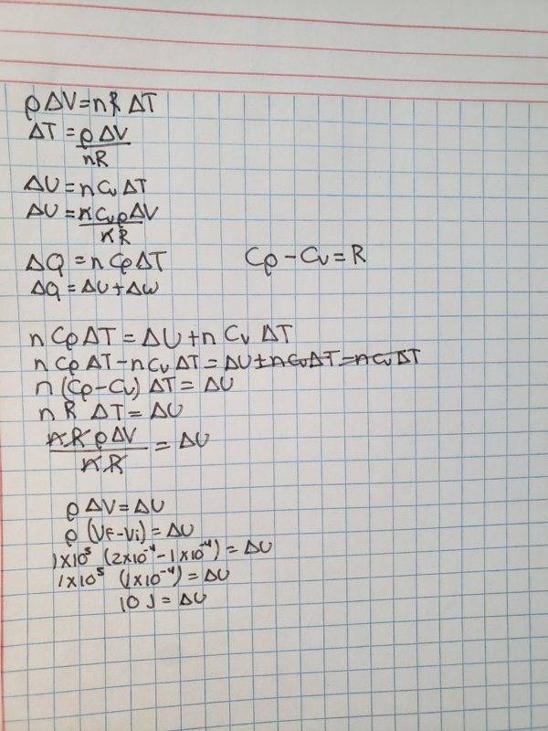

Dan13
A monatomic ideal gas expands from 100cm³ to 200cm³ at a constant
pressure of 1.0 × 10⁵ Pa. Find the change in the internal energy of the gas.
Included in my attempt at a solution
Problem Statement: A monatomic ideal gas expands from 100cm³ to 200cm³ at a constant
Relevant Equations: Included in my attempt at a solution
You almost had it, but not quite. You had $$\Delta U=\frac{C_v}{R}P\Delta V$$And we know that, for a monatomic gas, $$C_v=\frac{3}{2}R$$Therefore,...
