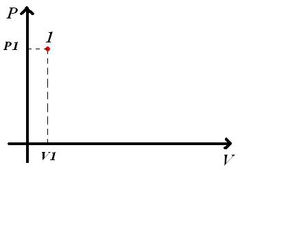

I choose a random point 1:

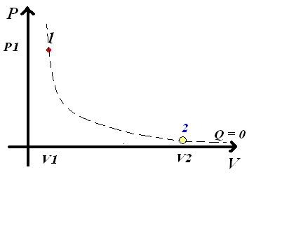

Then, I draw the adiabat that goes through 1:

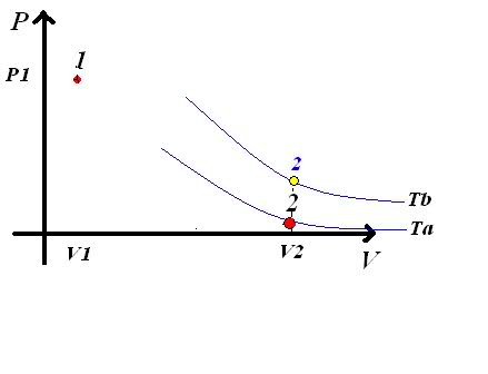

If this was a reversible process, then the blue 2 would be point 2. But now, since the process is irreversible and as a consecuence the work made by the gas is lesser, then the internal energy in 2 will be greater. As a consecuence, the temperature of point 2 must be higher than the temperature of the blue 2. Say the two isotherms Ta and Tb are such that Ta < Tb. Then (moving the blue 2 higher):

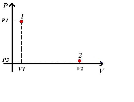

Point 2 will be located in the isoterm Ta, since it has a larger amount of internal energy (left?). Then finally this is what I have:
With each point associated with two different isotherms T1 and T2. Then there should be a different adiabat that goes through 2.
Is this correct?
If the final temperature is higher for a given volume, the final pressure will be higher. The path, however, results in less work being done. This means the area below the path is less than the area below the reversible adiabatic path.

But there's no way that point 2 is associated to a P2 higher than that of the blue 2, because there's no path from 1 to that 2 that encloses a smaller area than the path from 2 to the blue 2.
Sure there is. For example, if P drops to P2 immediately and expansion occurs at P = P2, the work done will be less. Or, if P drops to 0 immediately and pressure gradually increases as expansion occurs, the work done will be less (this is what occurs when a gas expands into a chamber that is initially at 0 pressure (vaccum).
AM
And that can still be done adiabatically?
Sure. Just make the process thermally isolated from the surroundings. As the gas expands, the internal energy will decrease by the amount of work that is done (dQ = 0, so dU = -dW). A reversible expansion (the gas is in thermodynamic equilibrium at all times) results in the maximum amount of work being done. So that is the limiting case. The work done is a function of the external pressure. If the external pressure is between 0 and P1 the gas will expand until the internal and external pressures are equal.AM
