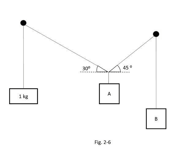

i Dont know why he uses sin-1c i need to find displacement
no equation
I know that if A moves down 1 unit b will move up square root of 2 and 1kg will moves up 2 unit
new90 said:
Homework Statement:: i Dont know why he uses sin-1c i need to find displacement
Relevant Equations:: no equation
You are wrong on both counts.
Draw a diagram showing the string from left hand pulley down to the junction above A. Draw it again with A a little bit lower. What is the change in length of that section of string?
i think none but I think is wrong

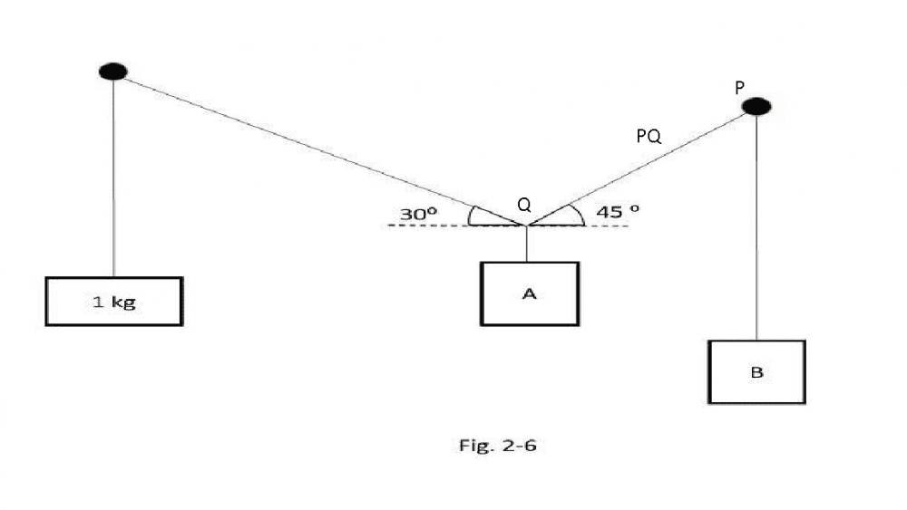

Let Q be the point where the strings join above A, and P be the point where the string going up and left from there contacts the pulley.
If A is pulled down a distance y, the junction of the strings moves down y to a new point, Q'.
How much longer is PQ' than PQ?
I think i can use the pythagorean theorem to find PQ' IM correcT?
It's easier than that, if you make a small approximation.
Drop a perpendicular from Q to the line PQ', meeting it at R. If y (the distance QQ') is small then the distances PQ and PR are near enough equal. So the increase in distance from P is RQ'.
What is the angle QQ'R? So in terms of that angle and y, what is the distance RQ'?
the letters are in correct place
Yes, except that I thought you phrased your question in terms of what happens to the 1kg mass, so P should be at the left hand pulley.
Anyway, you don't need to draw the whole diagram. Just draw the triangle PQQ', quite large, then drop a perpendicular from Q to PQ' to meet it at R.
The length of string from the pulley to the junction is PQ to begin with, PQ' after A has moved down. PQ is very nearly the same length as PR, so the increase in length of that section of string is RQ'.
What is the equation relating that increase to y (=QQ') and the angle PQ makes to the horizontal?

You might find it easier to think in terms of velocity components. If the joint above A moves vertically with velocity v, what component of that is in the direction of the pulley?
I didn’t get that, do you mean the component of vertical velocity along PQ?
The component of vertical velocity ##v## along PQ is ##v/2##
Right. So can you see new90's error in post #1?
If in one second A moves by ##v## units downwards, the 1 kg block will up by ##v/2## units in that one second. Am I right?
Yes, except that one second may be rather long. As soon as the angle changes the ratio will change, so it's more a statement about the instantaneous velocity ratio.
Note the guess in post #1 had it backwards, with the 1kg mass rising at twice the rate A descends. This is a common mistake.
