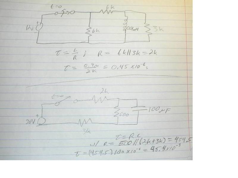

Time constant tao Which resistance do I use?

The top circuit is an example my professor did in class, and how he solved Tao. What I'm concerned with is how he is figure R for L/R
The second example is one I found online.
How do I figure the R to use? Is it simply the entire thevinin equivalent or a specific equivalent?
Find Thevenin resistance. That's the value you need to put.
In the second case, short the voltage source.
Thevenin resistance = 0.5k || (2k+3K)
In the first case, short the voltage source.
The vertical 6k becomes ineffective as there is a short across it. The 3k and the horizontal 6k at the top are in parallel with regard to the inductor. Hence thevenin resistance = 6k || 3k.
Oh man.. I forgot about shorting them out ahhh.. Thanks I appreciate it!
