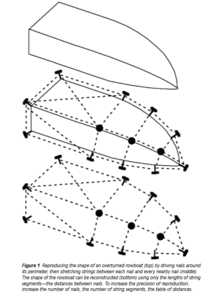

What Marolf does in his paper is giving a Lorentzian embedding of the r-t plane of a kruskal black hole, i.e. it describes the curved shape that you'd have to draw a space-time diagram in order for all the proper times and proper distances (or in general Lorentz intervals) to have the correct lengths. It's rather similar to the idea of finding the shape of a rowboat by driving a bunch of nails into it, measuring the distance between each pair of nails, and demanding that they come out correctly.
