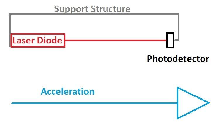

In the image below, we will be accelerating the entire apparatus. It won't ever reach a frame of inertia. Would someone in a different frame of reference be able to detect this acceleration from the output of the photo-detector?
As time slows and the distance the laser travels contracts; would the photodetector display this energy input to a stationary observer?
If we replace the photodetector with a perfect mirror and create a laser cavity, would we find an interference pattern in the middle of the cavity as we accelerate the apparatus?
If one adopts an accelerating frame of reference in which the assembly is at rest then the photodetector will see red-shifted light due to gravitational time dilation. This is a frame-independent fact that can be read from the photodetector's output.
If one stays with an inertial frame then the detector is always moving faster away from the light at the reception event than the source was moving toward the light when it was emitted. Doppler then says that a red shift will result.

So as the apparatus accelerates the photo detector output signal will decrease in voltage. Will it also decrease in amperage?
It will remain constant in voltage. Why would you expect it to change?

I guess I misunderstood redshift. What if the photodetector is replaced with a material that is only transparent to light slightly below the laser's frequency. If the laser light is redshifted enough, would it transmit through the material during acceleration?
The light is emitted with no red shift. It is received at the photodetector with a red shift. To a first approximation, the red shift is proportional to distance traveled in the accelerating frame. Yes, a chromatic filter attached at the detector could pass the red-shifted light.
For a fixed ongoing proper acceleration and a Born-rigid structure the redshift at the detector is fixed and unchanging. [Born-rigid means that the proper length of the structure is constant]

I think what the OP meant to ask was this.
If we could remotely observe the instruments measuring clock rate on a spaceship traveling at speed near c relative to us, would we see dilated time? Alternatively, if we could ask a passenger on the spaceship to communicate how fast time passes for him, what would he say?
The answer in both cases, is that we would see or hear that time passes normally on that ship.
I think its a clever question. The spaceship passenger speaks into his microphone, "normal" We hear the message as nnnnnooooorrrrrrmmmmmaaaaalllll because of the red shift, but it does not morph to ssssslllllooooowwww.

This is what the OP wrote, and the bold is mine:
So here is what I gather:
1. The frame the laser+detector is the same
2. This frame is accelerating and never an inertial frame
3. The OP wants to know if we simply look at the output of the detector, can we detect that it is accelerating?
So is the above correct or not?
