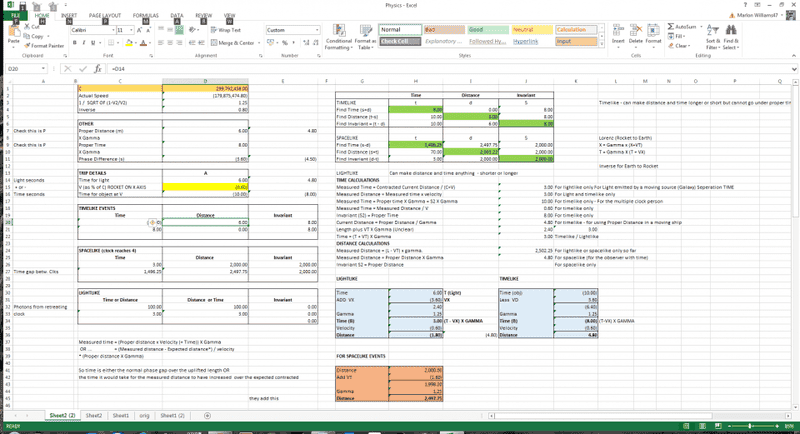

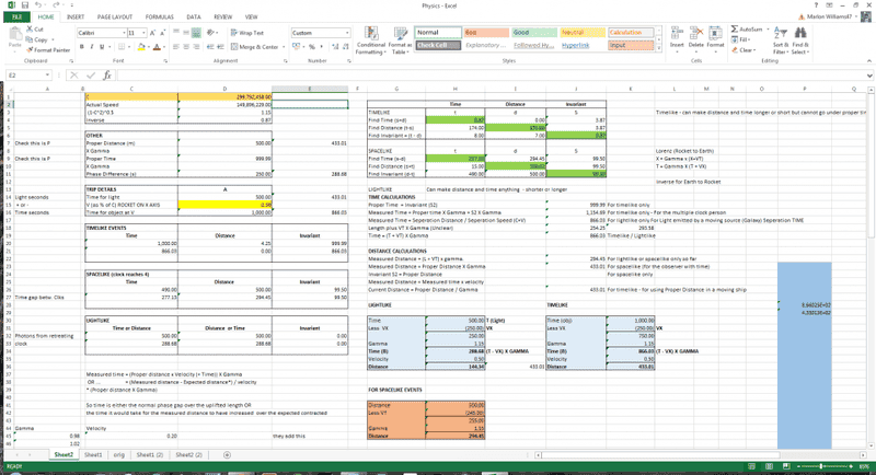

Here's my excel file - the boxes C-E rows 1 - 35 and G to J rows 3 to 11 are useful for playing around. Unfortunately I can't attach it but you can make one yourself link the cells and try different scenerios.
For example if you know the time and distance measurements for a specific observer, you can calculate the invariant interval and then use that to work out the time and distance measurements for another observer moving relative to the first.
