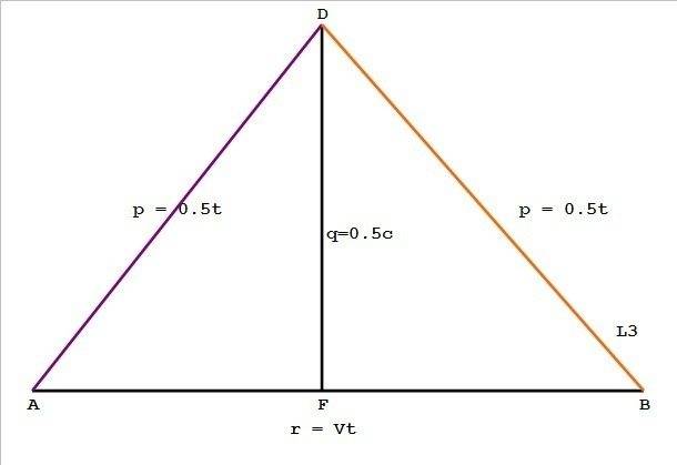

Can I answer? The bomb does not explode because
Ibix said:
Set up a train half a light second wide. In the train's rest frame the light pulse will take one second to cross the train and bounce back. Next to one end of this light clock set up a (much shorter) tennis ball clock that also takes one second to complete an out-and-back bounce. Rig a bomb to explode if the two clocks don't tick synchronously.
But, that's according to the train frame. What about at the platform frame? Let say the tennis balls travels 5000m/s compared to the light 300,000,000. And supposed the train travels at 0.6c, what would happen?
I draw a picture here, to make it clear.
Fo the train travels from A to B. It tooks t time from A to B.
So AB (r) distance is Vt.
The light travels to A->D->B. It takes t time. So, AD(p) (and AB) distance is 0.5t
We know DF(q) is 0.5c for in train frame, it tooks 1 second bounce back. So here it its
p=0.5t, distance in a factor of c
r=Vt, V in a factor of c
q=0.5
If we pythagoras r, we'll have. ##\frac{1}{2}r^2 = p^2 - q^2##
##\frac{1}{2}^2v^2t^2 = 0.5t^2 - 0.5^2##
##t=\frac{1}{\sqrt{1-v^2}}## Okay..., so ##t = \gamma##
##t=1.25 \text{ seconds}## So, 1.25 seconds for the platform is 1 seconds for the train.
##r = 0.75t##
The tennis ball travels at,...
Let ##V_{ball} = 5000m/s = 0.00005c##
##S_{ball} = 2 * \sqrt{V_{ball}^2+\frac{1}{2}^2r^2}##
##S_{ball} = 2 * \sqrt{0.0000000025+0.140625}##
##S_{ball} = 0.750000006667t##
Train frame: t = 1; SBall = 0.00005t
Platform frame: t = 1.25; SBall = 0.750000006667t
I hope this is true.
You're working way too hard for this.
We know that the light clock will tick every [itex]\gamma[/itex] seconds in a moving frame. The OP accepted that. If relativity somehow did not apply to tennis balls then the tennis ball clock would obey Newtonian physics and tick every second. But then we end up with a contradiction - the bomb would go off according to any frame except the [itex]\gamma=1[/itex] rest frame of the train, where it wouldn't. Which is nonsensical. Either it goes off or it doesn't.
The only self-consistent solution is for the tennis ball clock to tick at whatever rate the light clock ticks at, whatever frame is in use.
"We"? Whom do you mean by "We", I didn't know that ##t = \gamma##, before I did the calculation. :smile:.
The first post states this. It's also a standard result for time dilation - if two things happen at the same place a time t apart (in some frame) then in any other frame they happen [itex]\gamma t[/itex] apart. Note all the restrictions around when this simple form of the Lorentz transforms can be used.
