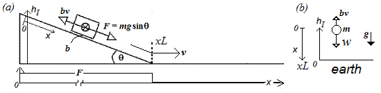

This equation specifies displacement x in terms of motion time t (starting from rest).
[tex]x = \tau g\left(t + \tau e^{-t/\tau} -\tau\right)[/tex]
where tau = m/b is the system time constant of a mass m suspended from a mechanical braking device with rectilinear damping constant b and g is standard gravity.
Can anyone help me find t as a function of displacement x? I'm having trouble with the logarithm algebra. I'm new to the forum, so any tips are appreciated.
This is a trancendental equation for "t", you won't be able to find an exact solution.
Thanks for that help.
I'm trying to predict the time down a ramp of known length xL as shown in the diagram. I'd like a closed form approximation to write in a code statement. This will set the transient analysis time based on the input data inside a computer simulation.
The differential equation solved for acceleration looks like this:
[tex]\frac{dv}{dt} = \frac{mg sin\theta - bv}{m}[/tex]
Any ideas appreciated.
