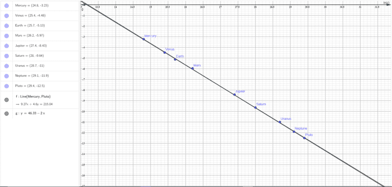

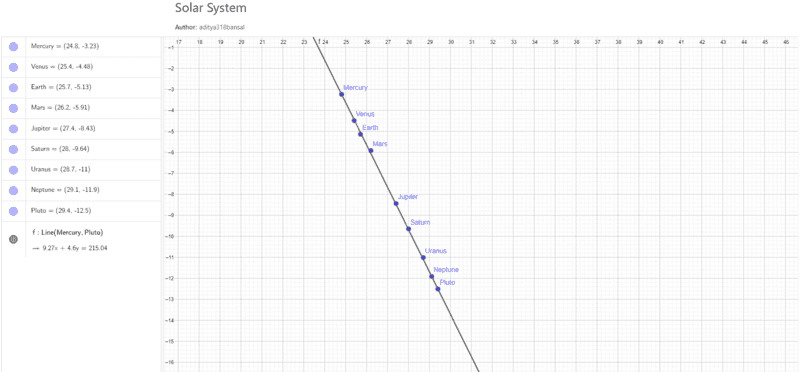

I solved both the problems. I plotted the graph in GeoGebra and obtained the following.
It looks cool, even if I do say so myself.
Note that I took the natural logarithm of the obtained results, and I converted the quantities to their SI counterparts and plotted the graph.
##ln(r)## is on the X axis where ##r## is in m, and ##ln(a)## is on the Y axis where ##a## is in ms-2. A distance of 1 on the graph equals 1 unit.
My question is, why does this happen. Why do we get a straight line on joining the points? Could someone please explain how this wonderful phenomenon occurs? I could give you any other data you may require about how I made this graph. Thank you.

Looking at the graph, can you read off m?

If you mean to determine the slope, then it is $$\frac {-9.27} {4.6} \approx -2.02$$.
Am I right?

Which means that the slope of ##\ln(a)## when graphed against ##\ln(r)## would be what?
It would be ##-2##. Am I right?

I think it's time to answer the question now, because I've the impression you get more and more confused by trying to get it out yourself.
All you need to answer your question, is Newton's 2nd Law and the formula for the gravitational force between Sun and the planets. We can consider the Sun as fixed in the origin of our reference frame, because it is much heavier than all the planets. Then the equation of motion reads
$$m \vec{a}=- \frac{G m M}{r^2} \frac{\vec{r}}{r}.$$
Now you can also consider the planets running on circles (which is not too bad an approximation for the planets in our solar system. With the given distances of the planets from the Sun and their periods of evolution you can calculate the acceleration
$$a=\omega^2 r=(2 \pi/T)^2 r.$$
Now you plot ##a## against ##r## in a double-logarithmic plot. From the equation of motion you get
$$a=G m M/r^2.$$
devide this by an arbitrary scale factor ##a_0## and take the logarithm. We forget for a moment the issue with the dimensionful quantities. You can just think of using standard SI units on both sides and only put the numbers of the dimensionful quantities under the logarithm. Then you get
$$\ln a =\ln(G m M/r^2)=\ln(G m M)-2 \ln r,$$
and you see that indeed in the double-logarithmic plot you expect to get a straight line with slope ##-2##, and that's indeed what you approximately get.

It is alright. Thank you for the correction. And by the way, this is the graph I get after putting this equation in the graph. Note that I calculated ##ln(GM)## by substituting the appropriate values to get the Y-intercept.
brochesspro said:
OK, now, other than the possible mistake which you made, my question is answered. I get the equation as, ln(a)=ln(GM)−2ln(r). Am I right?
Pretty close, do you not think?
