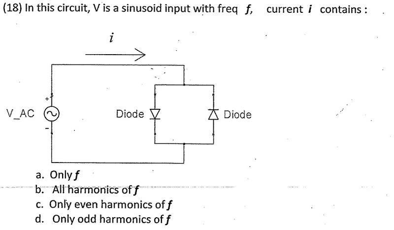

The circuit diagram is shown in the attached file..q18
The question 18 is regarding harmonics of current wave in the ac circuit having diodes.
My answer if option (a) , any mistake here..
I don't think we can assume ideal or idealized diodes here, for the simple reason that if the source is an ideal sinusoid, and the diodes were to drop a fixed 0.6V, then where does the remainder of the voltage disappear?
So I picture operation over the diode's exponential curve (which extends to infinity), and giving rise to a distorted alternating current (perhaps missing a portion around the zero crossings).
Being a distorted sinewave, it contains harmonics.

As diode is having a nonlinear behaviour can we say the output is like
I = a + b v^1 + c v^2 + d v^3 + ....
so will all harmonics come...
I don't think so. I think you should try to sketch the expected current waveform.
ok I will try.
