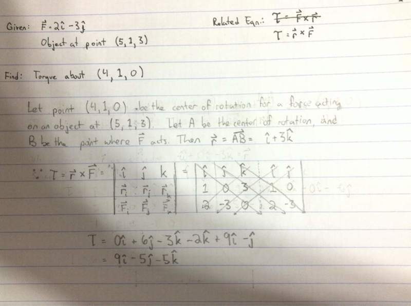

Okay, so I corrected it on paper. What I have down is:
Let point A be (4,1,0), the center of rotation for a force [itex]\vec{F}=2\hat{i}-3\hat{j}[/itex] acting on an object at point B, (5,1,3). Then [itex]\vec{r}=\vec{AB}=\hat{i}+3\hat{k}[/itex].
Therefore,
[tex]\tau = \vec r \times \vec F = \left| {\begin{array}{*{20}{c}}<br /> {\hat i}&{\hat j}&{\hat k}\\<br /> 1&0&3\\<br /> 2&{ - 3}&0<br /> \end{array}} \right| = 9\hat i - 5\hat j - 5\hat k[/tex]

haruspex said:
I get different coefficients for j and k.
And you are correct. Squelch, you made two small mistakes, probably due to inattention.
I'm not seeing the mistake. I was taught to take the cross product in the way shown in the picture, summing the components from left to right and subtracting the components from right to left.
edit: yeah, wow, i see that mistake now
I tried a different method (taking determinant) and got 9i+6j-3k. Does that match up better?
It is correct. Previously, you took the product 2*0*k=2k.
ehild
