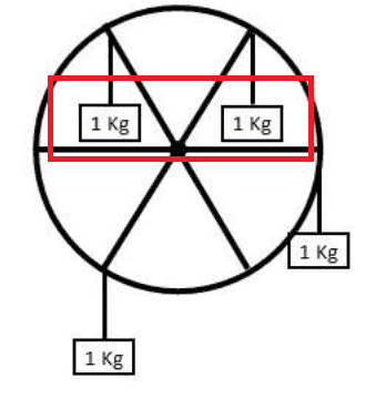

A 6 spoke wheel with a radius of 2 meters has 4 - 1 Kg masses hanging from the point where the spoke meets the rim as shown. What would be the net torque acting on the wheel?
Applying Rotational equlibrium, F1d1 + F2d2 = F3d3 + F4d4
F_{1}d_{1} + F_{2}d_{2} = F_{3}d_{3} + F_{4}d_{4}
m_{1} gR cos 60 + m_{2}gR cos 60 = m_{3}gR cos 60 + m_{4}gR sin 90
m1 = m2= m3= m4= m
R1=R2=R3=R4=R
\sigma\tau = sin 90 - cos 60 = 0.5 Nm.
Have I done this right?

paulimerci said:
Homework Statement:: A 6 spoke wheel with a radius of 2 meters has 4 - 1 Kg masses hanging from the point where the spoke meets the rim as shown. What would be the net torque acting on the wheel?
Relevant Equations:: Applying Rotational equlibrium, F1d1 + F2d2 = F3d3 + F4d4
R1=R2=R3=R4=R
You only have R as variable in your torque equation
You should be able to argue that the torques generated by these two masses cancel straight away

The result is correct. The reasoning is not. You cannot apply rotational equilibrium because there is a net torque (it is what you are asked to find!)
Your result also does not follow from the zero net torque equation.

\sigma \tau = m_{1} gR cos 60 + m_{2}gR cos 60 - m_{3}gR cos 60 - m_{4}gR sin 90 = -sin 90 + cos 60 = - 0.5 Nm. Have I done it right now? It looks like I got negative torque.
paulimerci said:
##\Sigma \tau = m_{1} gR cos 60 + m_{2}gR cos 60 - m_{3}gR cos 60 - m_{4}gR sin 90 = -sin 90 + cos 60 = - 0.5 ##Nm. Have I done it right now? It looks like I got negative torque.
It's negative because it is clockwise.
But your answer is wrong numerically. What is the weight of a 1kg mass at Earth's surface?

Are you cancelling out the m's and R's.
What should be the final equation to determine the torque?
your torque can be negative, or positive.
You did not up front specify which direction - clockwise or counterclockwise - is in the positive direction.
Although, implicitly, the positive direction can be gleamed from your balance of torques equation as being counterclockwise.

Oh. I forgot to include g
I got the answer as -9.8Nm.
Right, using the commonest convention that anticlockwise is positive.
