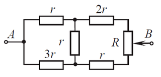

Total resistance in the circuit
The discussion revolves around determining the total resistance in a circuit that includes a potentiometer with a resistance of ##R=9r##. Participants are exploring how the position of the wiper affects the total resistance, with references to Ohm's law and Kirchhoff's laws.
  • Mixed
  • Participants are attempting to apply Kirchhoff's laws to analyze the circuit, with some suggesting the use of a Y-Δ transformation for simplification. Others express uncertainty about the equations derived and the relationships between variables.
There is active engagement with various methods being proposed, including algebraic manipulation of equations and the application of circuit laws. Some participants have identified potential errors in the equations and are questioning the consistency of variable definitions. Multiple interpretations of the problem setup are being explored.
Participants have noted inconsistencies in the use of variable definitions, particularly regarding the parameter ##x##, which represents different resistances depending on its range. There is also mention of imposed homework rules that may limit the methods available for solving the problem.
kaspis245
189
It is known that total resistance of the circuit is dependent on the position of the wiper in potentiometer ##R##. Find the biggest and the smallest possible total resistances of the circuit. Potentiometer resistance is ##R=9r##.
Ohm's law.

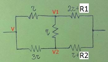

Here's a redrawn image:
where ##R_1+R_2=R##.
This circuit reminds me of Wheatstone Bridge, so I approached the problem like this:
##V_1=\frac{2r+R_1}{3r+R_1}V##
##V_2=\frac{r+R_2}{4r+R_2}V##
I don't know what to do from here.

Can you use a Y-Δ transform ? It works nicely with the three resistors on the left. (r, r, and 3r)
I've tried Y-Δ transform, but since I am not really familiar with it I don't want to get too much into it. I haven't studied it yet, so it would be better if I solve the problem without it.
By the way, I've found a simpler way to write the equations:
##\frac{V_1}{2r+9rx}+\frac{V_1-V_2}{r}+\frac{V_1-V}{r}=0##
##\frac{V_2}{2+(9-x)r}+\frac{V_2-V_1}{r}+\frac{V_2-V}{3r}=0##
##R_{total}=\frac{V}{\frac{V_1}{2r+9rx}+\frac{V_2}{r+(9-x)r}}##

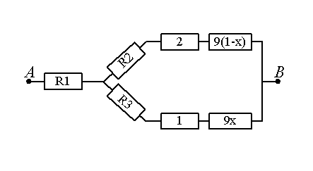

Maybe it's time to consider the Y-Δ transformation .
It's really not that difficult, particularly for the values here.
The delta is the triangle on the left. Those are the resistors in Loop a . Point A is equivalent to point A in your overall circuit. Point B is at the node which you labeled with voltage V1 on some of your diagrams. Point C is at the node which you labeled with voltage V2 on some of your diagrams.
The idea here is to replace that given set of resistors connected in that way, with a set of resistors in a "Y" configuration, as seen on the right. We need this set of resistors in the Y-configuration to behave exactly as the original set in the Δ-configuration in regards to nodes A, B, and C.
What this boils down to is that the resistances between the three nodes (taken pair-wise) must be the same for both configurations.
Starting with the Δ-configuration, find the resistance between A & B, between B & C, and between A & C .
For example: between A&B: The single resistor, r, is in parallel with the series combination of r and 3r. RAB = (4r2)/(5r) = (4/5)r .
RBC gives the same result: RBC = (4/5)r .
For RAC we have 3r in parallel with the series combination of r and r, giving RAB = (3r⋅2r)/(5r) = (6/5)r .
Now figure out what RA, RB, and RC must be in the Y-configuration on the right. For each pair here, we only have two resistors in series.
We must have:
RA + RB = (4/5)r
RB + RC = (4/5)r
RA + RC = (6/5)r​
What do you get for these?

Okay, now re-draw your circuit and plug in the new values in the appropriate locations:
Note that "r" can be treated as a scaling value since every resistance in the circuit is a multiple of it. So you can drop the "r" from the equations while you work out the minimums and maximums without losing generality. Just tack the r's back on at the end!
