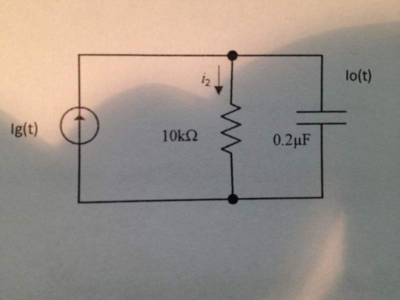

RC parallel circuit with the resistor first and the capacitor next.
find the transfer function H(jw)

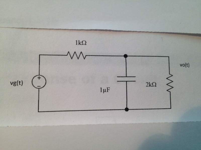

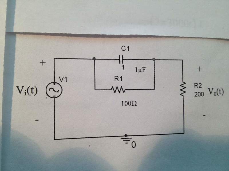

resistor first then capacitor
transfer function of a circuit with resister serial then capacitor and resister parallel

RC parallel would it be H(jw) = jw/(jw + 1/RC)
the other
H(jw) = jw(c/(R_s +c))/(jw + R_sC /(R_S+c)R

H(jw)=jw/(jw+1/RC)
H(jw) = jw[C/(Rs+c)]/ {jw +Rsc/[(Rs+c)R ]}
H(jw) = {[1/(R1C1)] - w^2 } / {1/(R1C1) - w^2 +jw/(R2C1)}
Okay, that's better.
In the first diagram I interpret the output to be the capacitor current Io(t), even though the diagram is missing the current arrow on that branch. Traditionally the "o" subscript indicates an output. Your H(jw) would be correct for taking i2 as the output though.
The others are a bit more complicated to evaluate since there are several ways to simplify the expressions, and I'm not keen on spending time to see if yours can proven as identities of my own results. So. Perhaps if you could provide a bit more detail about your derivations (show and explain some intermediate steps) that would be excellent.
One thing I notice is that they have provided actual component values, so for final results they may be expecting you to plug them in for final results.
