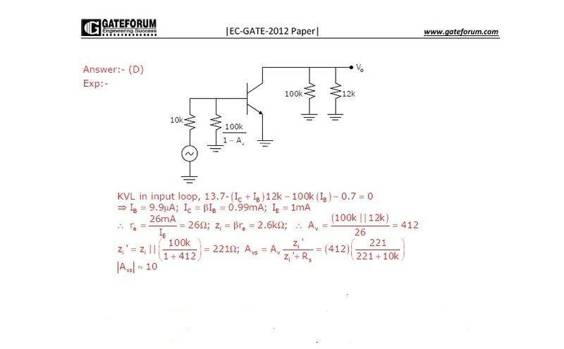

lazyaditya
176
The circuit is shown below and i am asked to find out the voltage gain A(v)
Beta = 100 and Vcc = 13.7 volts Common emitter configuration.
Voltage Gain is equal to the ratio of output voltage to input voltage .
Don't know how to proceed as there wasn't any v(i) or v(o) given in the equation, how should i start ?

i got the solution right now and the person is considering 100 kohm as the part for conduction i am posting the solution over here please help , i am not able to understand !
here it is !

Lazy,
Base current change in the base-emitter junction for 1 volt input will be 1/10k = 0.1ma. Multiply base current by beta gives 10ma collector current change. Multiply collector current by 12k gives 120volts. So small signal gain is 120/1 = 120
Ratch
but A(v) is 10
Lazy,
So where did I go wrong? Find my mistake.
Ratch
do we calculate the voltage across Rc or across load resistance that will be emitter resistance i guess ? And isn't the 13.7 volts the biasing voltage ! won't it affect the base current in some manner ?
plus we are just assuming it to be having 1 volt input signal and considering it small signal analysis giving linear model ! can't it be large signal in which each gap in Ib will create non linear effects in Ic!
according to the solution given to me i wasn't able to understand the equivalent circuit the person has drawn !
