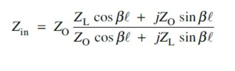

(a) A transmission line has a length, ℓ, of 0.4λ. Determine the phase change, βℓ, that occurs down the line.
(b) A 50Ω lossless transmission line of length 0.4λ is terminated in a load of (40 + j30) Ω. Determine, using the equation given below, the input impedance to the line.
[see attachment for equation]
As above.
(a) β = ω / fλ
∴ βℓ = ω 0.4λ / fλ
= ω 0.4 / f
= 0.4x2π f / f
= 0.8π (=2.513 to 3d.p.)
(b) Zin = 50 x [ (40cos0.8π) / ( 50cos0.8π + 30sin0.8π) ]
= 70.91 ohms
Do these answers look correct? Seems worryingly straightforward.
I think you have to consider the reflection from the mismatched termination.
Ok, I can see that I've manipulated the given formula incorrectly for (b). Second attempt:
Zin = Zo [ ( (ZL COS βℓ) + (jZo SIN βℓ) ) / ( (Zo COS βℓ) + (jZL SIN βℓ) ) ]
= 50 x [ ( (40+j30)COS(0.8π) + (j50)SIN(0.8π) ) / ( 50COS(0.8π) + j(40+j30)SIN(0.8π) ) ]
= 25.47 + j5.9
How does this look?

OK. What was with the ω and f? β = 2π/λ so βl = (2π/λ)(0.4λ) = 2.513 radians.
b) I didn't check your math but the formula you used in your later post looks right.
Hello there, I am struggling with the maths of the equation for b.) Zin = Zo [ ( (ZL COS βℓ) + (jZo SIN βℓ) ) / ( (Zo COS βℓ) + (jZL SIN βℓ) ) ] I have attached my working out and have computed the answer with my calculator in Radians but am not at all confident on the answer I have achieved.
You should have reduced numerator and denominator without changing to polar coordinates:
Z = {(a+jb) + (c+jd)} / {e+jf) + (g+jh)} = {(a+c) + j(b+d)} / {(e+g) + j(f+h)}
THEN changed numerator and denominator to polar.
Rule: for add & subtr, work in rectangular; for mult. & divide, work in polar.
I won't check your math but I suggest you redo using the above stratagem.

(b) A 50Ω lossless transmission line of length 0.4λ is terminated in a load of (40 + j30)Ω. determine, using the equation given below, the input impedance to the line.
I have calculated Bl which I think is correct and converted the load Zl to polar.
βl + 2π x 0.4 = 0.8π
βl = 2.513 radians = 144°
ZL = 40 + j30Ω
ZL = 50∠36.87°
Am I correct in thinking that the 50Ω of the lossless transmission line is used as the Zo.
once put into the formula the result I get is Zin = 50∠36.87, 40 + j30Ω which is equal to the load which makes me think it is incorrect.
yes
thanks
i can't check your math but you're on the right track
Thank you rude man for the very fast response, I keep doubting the answers I'm getting and keep trying to find ways to double check my results. I will continue with the assignment and hopefully get it completed soon. cheers
Can I ask how are you getting to this answer mathematically??
There is a point in the equation where j29.5/_36.87 needs to be changed to rectangular form.
This would be J29.5cos(36.87)=j23.6 and J29.5sin(36.87)=JJ17.7
It's at this point JJ17.7 is equal to minus 17.7 and it throws the answer that you are getting out?
If JJ17.7 was equal to +17.7 I get to your answer but j squared x 17.7 is a minus and from there I am not getting to an answer where ZL is equal in Zin.
Am I missing something? :-(
Hi Matt, I only handed the assignment In last Saturday so have just checked if I have yet received any response and I have. it has been highlighted that I have made a sign error and it should have been a minus so you are probably correct. I have just recalculated my equation and the result I now have is 26.143∠13.05, 25.466 + j5.912. is that anything like your answer. cheers
