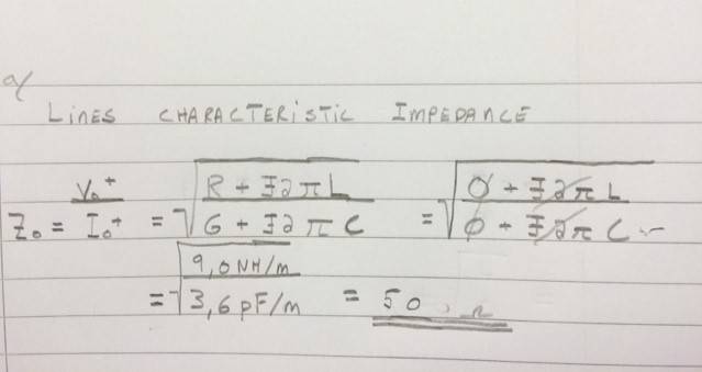

A lossless transmission line has an inductance of 9.0 nH / m and a capacitance of 3.6 pF / m.
a) What is the line's characteristic impedance?
b) Calculate the phase constant of a frequency of 1 GHz.
Equation of characteristic impedance of a transmission line:
Z0 = sqrt( R+j2piL / G+2jpiC )
Where R and G = 0, because lossless transmission line.
For a I just used the equation above, but for task 2 I'm not sure what to do. I don't now how to get Sin/Cos to the equation so I can fint the phase constant. Do I need to do something to the equation above?

For a lossless or for that matter distortionless line there is a very simple formula relating the phase constant to the radian frequency, inductance per unit length and capacitance per unit length, all of which you have. SI units are rad/m.
Thanks a lot for you respons. I really appreciate it. Do you know what the formula is, or where I could find it? I have seen in the book, but can't find it. Also I have added what I done in the first task. Should I use the result from that? I got 50 ohm.
  • Handwritten notes titled Lines Characteristic Impedance: Z0 = V0+/I0+ = sqrt((R + jωL)/(G + jωC)) = sqrt(9.0 nH/m / 3.6 pF/m) = 50 ohm, with the lossless terms crossed out.
There are many places on the Internet where you can find that formula. No, that formula does not include the answer to part (a).
