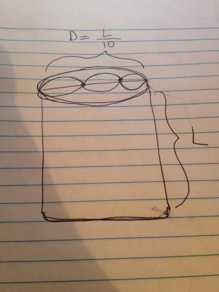

The problem is that I do not even know how to sketch the wave-form. I do not even think that I understand what's the point of this problem.. maybe that's why I cannot solve it...
Here is an attempt for a sketch but I am not sure if its right..
Good - you got the wave-form on the string - now you can write out the wavelength in terms of L.
Notice that one wavelength fits 2/3rds of the string...
On the same diagram, you can sketch in the pressure wave for the can.

Simon Bridge said that I can sketch in the pressure wave for the can what does he mean by pressure wave?
If you prefer, sketch the logitudinal wave along the can.
The wave in the can is a sound wave in air... i.e. a wave of variations in air pressure.
You have notes that show the harmonics in a tube that is open at one end.
You can reason it out ... in the logitudinal wave, the air particles move the most at antinodes, and the least at nodes, where do those have to be? You are also told that the wave is the fundamental.
This way of reasoning through the physics is more reliable than trying to remember the right equation.
