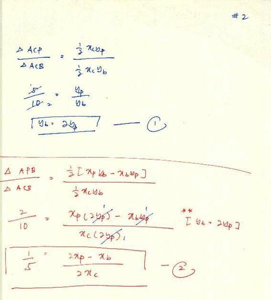

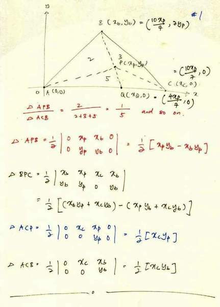

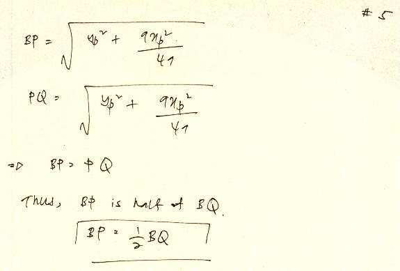

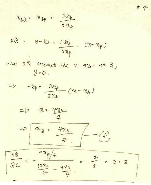

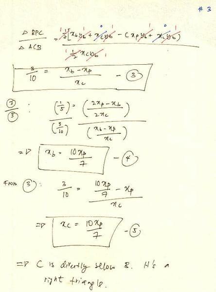

P is a point on triangle ABC such that area PAB : area PBC : area PCA = 2 : 3 : 5
a. Find AQ : QC
b. Show that BP = 0.5 BQ
a. i found that AQ : QC = area QAB : area QBC, but i don't know how to continue ( the answer is 2 : 3)
b. sorry, I'm clueless...
thx

yes P is a point inside the triangle and the straight line BP intersects the side AC at point Q.

Coordinate geometry
Words have spreaded
wow, you use geometry coordinate again to solve triangle problem.
