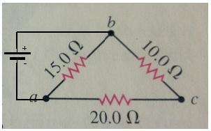

Instinctlol
79
I am not sure how the configuration would look like if we add a voltage across these points. I have drawn out what I think it would look like after a potential is applied across Vab. My question is, is this drawing correct?? What about Vbc and Vac?
This is question 26.5.
And here is my attempt for (a)
Once I figure out the configuration, I can easily add up the R_eq and find the I from that. But I need to make sure my configuration is correct!
For a diagram for part (a), the voltage source should be drawn between nodes a and b. You've not labeled node a correctly in the second diagram.
What should the 20ohm be connected to?
If the instructions say to put the voltage source between nodes a and b, then that's where you connect it!
Ohhhhh, duh... Thanks!
