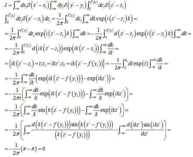

Here is the integral:
What I'm trying to do is starting with the third integral over zi and with the help of integral definition of DeltaFunction i want to calculate it. As you can see f(yi) has no influence on the integral. Am i right here?
No, you're wrong
First, in the step \frac{1}{2\pi}\int_0^{f(y_i)} dz_i \int_{-\infty}^{\infty} dk \exp{(i(z^{'}-z_i)k)}=\frac{1}{2\pi}\int_0^{f(y_i)} dz_i \exp{(i(z^{'}-z_i)k)} \int_{-\infty}^{\infty} dk, you can't take the exponential out of the integral w.r.t. k because it contains a k.
Second, you don't need such calculations. The integral \int_0^{f(y_i)} dz_i \delta(z^{'}-z_i) is zero if -z^{'} \epsilon\!\!/\ (0,f(y_i)) and is one otherwise.

I don't think you are right. If you've got something like that:
you can calculate the integral over x thinking that y is a constant. Then you come back to integral over y. Maybe i misunderstood something?
I know, but i'd like to write it down analytically. That's why i use integral definition of DeltaFunction.
Oh yeah...you're right. I thought you were going to integrate w.r.t. k.
Well, then you certainly should know that there is something wrong with your calculations. Because f(y_i) does affect the value of the integral. But I don't see any problem!
I should say such calculations can be very tricky but since we know that your result is wrong, you should either find what's wrong with your calculations or abandon them.

Dirac delta is an even distribution meaning \delta(-x)=\delta(x), so you can write \int_0^{f(y_i)} dz_i \delta(z^{'}-z_i)=\int_0^{f(y_i)} dz_i \delta(z_i-z^{'}). The first is non-zero only when -z^{'}\epsilon [0,f(y_i)] \Rightarrow z^{'}\epsilon [-f(y_i),0] and the second one is non-zero only when z^{'}\epsilon[0,f(y_i)], So the integral is non-zero only when z^{'}=0. That's what you should assume from the first place, before doing any other calculation.

if the integral is non-zero only when z′=0 z^{'}=0 , it is a little bit weird . and f(yi) has no influence on the integral as it was supposed, but i doubt it.
