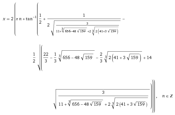

Here's the question.
Find the solutions of the equation tan(x)=2cos(x)+1 if 0 ≤ x ≤ 2π.
I know this question can be solved by observing the graph but is there any other ways (like algorithms OR some Trigonometry rules) to solve this, I couldn't figure that out.

Hello PhamCy, :welcome: !
Nice try, but PF asks a little more from you: make a start with the solution and we'll help you.
For example: substitute ##\tan x = {\sin x\over \cos x}## and see where it leads you
Way beyond what you can solve analytically with high school mathematics. WolframAlpha knows how to solve it analytically, here is one of the solutions:
Oops, I 'missed' the +1 which makes things difficult o:)
You could express the relationship as a polynomial in ##\cos\theta##, and then find the roots of the polynomial using something like Newton's method.
Turn everything into [itex]\cos x[/itex] to get:
[tex] 4\cos^{4}x+4\cos^{3}x+2\cos^{2}x-1=0[/tex]
From here solve it using whatever method you like. I would advise you plotting the polynomial first.
