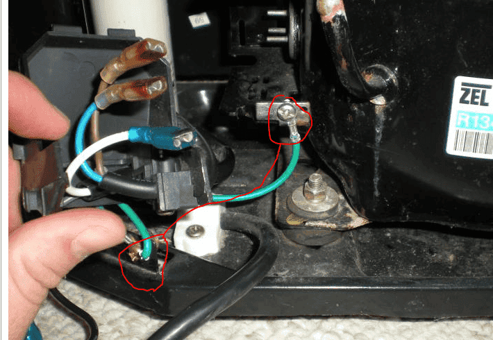

Here's a case in point. I bought a new refrigerator and its supplied plug is just 2 prong (the black plug in picture above).. no ground. If you will go to appliance stores nationwide.. refrigerators don't have ground. In other countries.. do your refrigerators really have ground? This is the front of the refrigerator. It's latest Panasonic inverter:

Ok. Here's from my other countrymen including expats. He said:
https://www.philippines-expats.com/topic/29039-grounding-of-electric-appliances/
"With our new rental we just bought several appliances. I noticed that both the refrigerator and microwave came with a separate ground wire. The instructions said to connect it for safety purposes but not where to connect it to.
Now our house has both 2 pronged and 3 pronged outlets, but I know in the Philippines just because something is 3 pronged does not mean it is properly grounded.
I know nothing to speak of about electricity but don't believe there is any kind of grounding rod in the kitchen. Is there any value to using these grounding wires and where do I connect them to? "
another's reply to it:
"I think it is meant to be attached to the cabinet. If it shorts out it will trip the circuit breaker but don't take my word for that. "
and anothers' reply:
"Good thing. I have a couple of appliances with that grounding wire hanging on the back. Its been many years and it is not attached to anything. So long as I get no static shocks or feel the vibrations then I say TIP, right Mogo?"
and another's reply:
"In my area in north Luzon there is no third grounding wire supply by the utility co. Unlike the U.S. which use the three wire system with grounding protection for the user and appliances. Almost all filipino s i know unplug all appliances during bad weather, thunder and lightening. "
They don't know where to connect the hanging wire. So most either don't use it or just stick it to cabinet. What they don't know is that even if your stick the hanging wire to earth.. it won't trip the breaker if it's not connected to the centertap of the utility pole or transfomers, right? It may be basic thing to you but most of my country men don't know about it. I only learned it this 2 weeks here.
