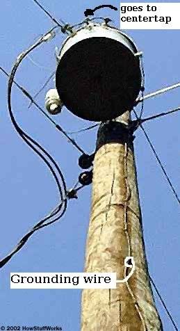

In US,
That little bare copper wire along the side of the pole Earth's the centertap.
Utility pole with a large black cylindrical transformer at the top, a label reading goes to centertap, and a bare grounding wire running down the pole labeled Grounding wire.

jim hardy said:
i don't understand - is there no connection to earth, right at the transformer supplying your building ?
Why then do you call it "Ground" ?
In US,
What would happen if the pole centertap is not grounded? I'd use my high power binocular to check the pole from 10 meters away if it's grounded.

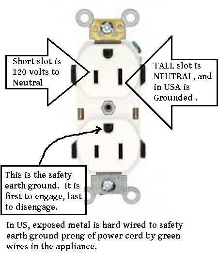

Photo of a white US duplex wall receptacle with labels: short slot is 120 volts to Neutral; TALL slot is NEUTRAL, and in USA is Grounded; the round hole is the safety earth ground, first to engage, last to disengage. Caption: In US, exposed metal is hard wired to safety earth ground prong of power cord by green wires in the appliance.
In US we are allowed to use a metal conduit or raceway for the safety Earth ground conductor between receptacle and breaker panel so long as it is of "approved" design.. In non conductive or discontinuous conduit we must run a green wire with the hot and neutral wires.
It is not clear what you mean by
kiki_danc said:
use the neutral as line 1 to neutral to get 120 volts service.
Any wire connected from tall slot to transformer centertap would serve as a neutral line but you might be violating your electrical code - i wouldn't know.
In US you CANNOT use the same conductor for both Neutral and safety earthing functions.
Neutral carries normal load current back to transformer centertap
Safety Earthing Conductor (often called Protective Ground) carries current ONLY when there's been an insulation breakdown.Draw yourself a centertapped winding schematic like i did in post 47,

Neutral is tied to ground to keep the house wiring near ground potential , Two examples follow:
1. A single primary to secondary short in the pole transformer would raise an ungrounded secondary to however many thousands of volts is primary winding. That would overstress the insulation in the household appliances and wiring.
Grounding the secondary let's that single fault pass enough current to open the transformer's primary side fuse thereby protecting the house wiring ..
2. A lightning strike to the top of the pole will raise Earth's potential near the bottom of the pole as charge flows away from the base of the strike.
Neutral being connected to Earth at entrance to house will raise potential of house wiring to follow potential of Earth at the entrance,
thereby minimizing voltage between house wiring hence house appliances and the floors they sit on.
The whole house with its contents rides atop the elevated Earth potential as if on a magic carpet.
So there's little potential difference inside.
That's why there's a ground wire along the side of the pole from bottom to top, to encourage the lightning to find Earth there and not via the house..
In US that wire goes to bottom of pole and is coiled there into a spiral that maximizes surface area for charge to get into earth.
