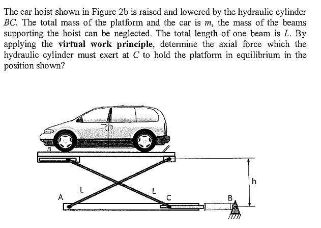

https://www.physicsforums.com/attachment.php?attachmentid=65907&stc=1&d=1390369310
I've been stuck on doing my revision on this problem.
The equation of the virtual work, from what I deduce is
[du = 0] -Pdx + mg dh
However the answer given is
https://www.physicsforums.com/attachment.php?attachmentid=65908&stc=1&d=1390369325
I'm not unfamiliar to these types of question as I've done quite a few of them. But, I just couldn't understand how'd the answer arrive to that.
I know P, is the force acting at the hydraulic extension at bc, and mg is the downward force of the car and the platform.

You need to relate dh to a change in ds, a differential distance the piston moves. This is just geometry.
