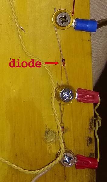

  • #34
I have another question on the diode. In reading up on diode technology, I see it is directional. Does this apply to the crystal radio? The right side of the coil is connected directly to the diode.

  • #35
Mark Palmer said:

  • #37
I'm not sure if it really makes a difference, some one else may comment...
Normally it would go in the other direction as in my post on page 1 of this thread. That is the black bar on the diode should be towards the earpiece

  • #38
Nope, no difference at all.
