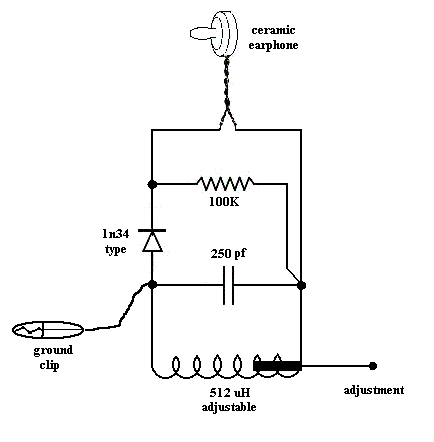

Hello,
I bought an electronics kit for my 12 year old brother (and perhaps a little for myself too...) for building a crystal radio.
I would like to understand what's going on when I tune the radio, so that I can explain it to him. It's a simple setup, where changing the position of a ferrite rod within a coil of wire does the tuning, but how does that work?
This circuit diagram is very similar, but the design I have does not make use of a resistor.
Any help would be appreciated!
P.S I have an understanding of physics akin to A-Level

How about:
The radio waves act on the circuit like, say, the wind pushing on a child's swing.
But the swing prefers to move at a particular frequency - so it gets it's biggest movement if the wind gusts near that frequency. (You feel this this from pushing the swing yourself.) In general there are lots of wind gusts at all kinds of frequencies - so the properties of the swing will select-out the particular set of gusts that have the right frequency.
The phenomenon is called "resonance", you can look it up for more detail.
Radio waves play the role of the wind gusts - there are lots of different frequency radio waves about all the time, the circuit is sensitive to being "pushed" by a narrow range of them depending on the values of the capacitor and the inductor.
The values of the inductor and the capacitor determine the frequency that the radio is sensitive to.
You change the inductor by (a) changing the number of turns in the coil or (b) changing what is inside it (changing the position of the ferrite is good enough for that, you could also change the whole material to something else).
You change the capacitor by changing the separation between the plates (this is how it is normally done).
Look up "variable capacitor".
That help?
I think when you change the position of the rod, the inductance of the coil will be changed which leads to the change of the resonance freuqency of the circuit.
this circuit is like a filter to the received radio waves and the frequency you wanted can be adjusted by the inductance value by changing the position of the rod.

Thanks a lot, that's a useful analogy.
On the PCB that came with the kit, the symbol for a variable capacitor is printed, but a normal capacitor is provided. I think the same circuit board is used for other kits that this company produces, but suppose I did have a variable capacitor, would this be used instead of varying the core of the inductor?
It's all built now, my brother surprised me with his steady hands when it came to soldering. Just need to wait for the rain to stop and then he'll be going up a tree with the aerial!

That's right - it is best to have only one variable component.

The missing component in these explanations so far is the term "PTO."
The circuit supplied is a PERMEABILITY TUNED OSCILLATOR. Made famous by Collins Radio in us by US DoD radios during the cold war prior to MASSIVE advances in surface mount device physics. The PTO allowed for vast miniaturization of "lumped tuned" circuit components and standardization of circuit designs over great quantities of the rf spectrum. The accolades being said, PTO's are now a very rare circuit because they are so esoteric (read - extremely finicky and hard to make work correctly in the home experimenters workshop. This is because of the physics of the tuned core. Hey I thought a 12 yo asked this question!)

... but suppose I did have a variable capacitor, would this be used instead of varying the core of the inductor?
Yes. It just needs either or both to be variable.

And here I was poised to explain why you'll need to add provision for connecting to an aerial, seeing your schematic lacks such, and it appears you already have that fitted.
Good luck with your experimenting. In a location with good reception, e.g., the suburbs, merely connecting the alligator clip to the metal frame of a window can be sufficient. Though in strong signal areas it can be difficult to separate stations close together in frequency.
