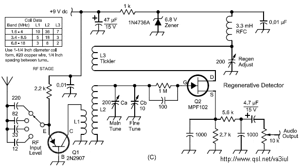

I have a minor bit of circuit experience. As a fun project id like to build a shortwave radio. Does anybody have any tips on where to start.
Super-regenerative receivers are the simplest to make, but are difficult to tune:
More advanced are heterodyne designs, which is actually a basis for modern radio topology. With an access to an oscilloscope it would be easier to construct one, and troubleshoot.

I would suggest, though, that you consider getting into a hobby level electronics course where you could find out enough about how receivers work to make a good choice about what to build and maybe even design your own.
Amateur Radio offers a wonderful opportunity to learn about Electronics. If there is an Amateur Radio club or a school offering electronics instruction, maybe you could try to take advantage of that. They are usually free or run at cost price by enthusiastic volunteers.
The shortwave bands can be pretty dead at the moment due to a lack of sunspots, so you have plenty of time to consider what to build. Maybe in about 3 years it will be a lot better.
In the meantime, simple radios are not likely to hear much.
The current trend is towards Software Defined Radio using your computer to do some clever stuff and making the receiver hardware simpler.
