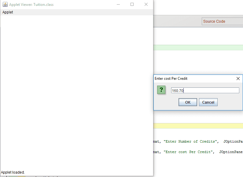

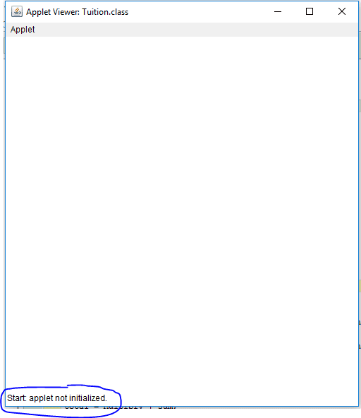

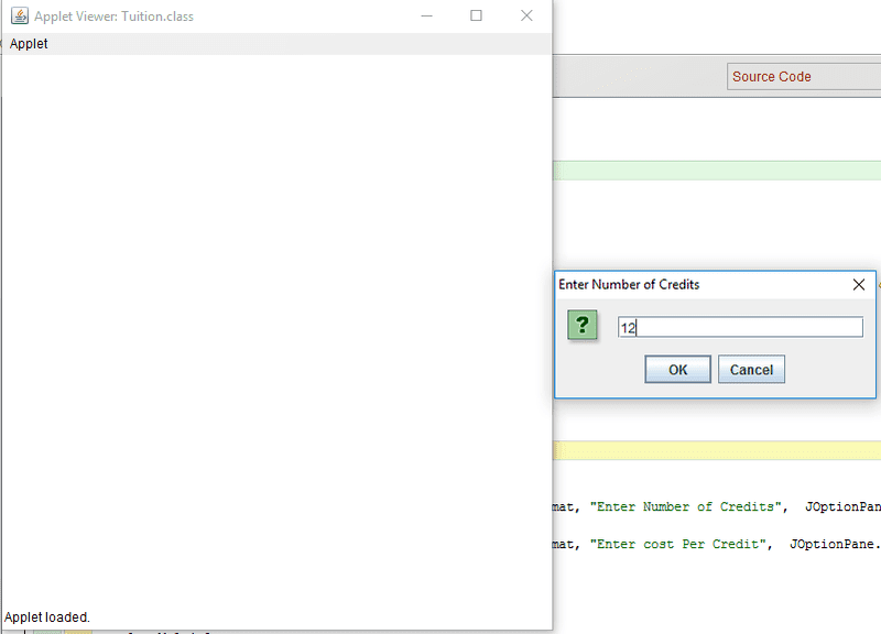

Hello,
I am writing a program that takes a users input of how many credits they're taking, and the number of dollars each credit is. The book and parking fee is a constant number (no change). I'm using JOptionPane so users can enter 2 values, 1 for number of credits, and the other for dollars per credit. I want to enter a number such as; 135.65 into the input. When I do that I get (you can see in the screenshot) a blank applet. When I use just integers it runs fine and outputs total and everything, except when I enter a decimal it doesn't execute properly. I'm new to Java Applet and was wondering why can't 'double' work. Also, how can I fix it so I can enter decimal numbers? I'm using BlueJ if you're wondering.

number2 is type int. If in the first line above you entered something like 123.45, the call to Integer.parseInt(input); will return the truncated version of the input string that is appropriate to store in an int variable. IOW, input will be the string "123" in this case, and number2 will be the integer value 123. The fact that DPC is type double is really irrelevant here, since number2 can't contain the fractional part of the input number. What gets stored in DPC is just 123.0.
Instead of using Integer.parseInt(input), use Double.parseDouble(input).

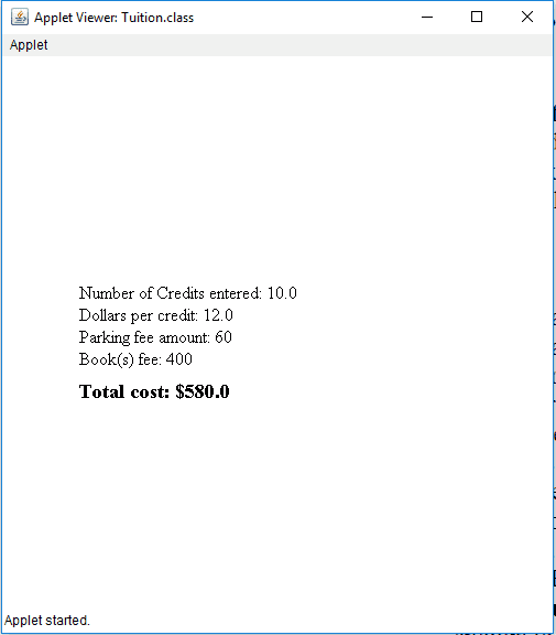

Okay, I took your suggestion in renaming the variables. Also, I changed it to Double.parseDouble which helped a lot. In my assignment, it wants the output to be formatted to 2 decimals. If you see in my picture, it formats to one decimal. I added this to my code to see if it works
At the top in public class tuition extends JApplet

FritoTaco said:
Edit: Made a few updates to code, created a method class called calculateTuition but still can't add a leading zero at the end of the total.
That's not a leading zero--it's a trailing zero.
Try this:
Java:
NumberFormat numberFormat = new DecimalFormat("#,###.00");
This format pattern will give you two decimal places and will add a comma separator at the thousands place. For more info, see http://docs.oracle.com/javase/6/docs/api/java/text/DecimalFormat.html.

Alright, thanks. I'll keep that in mind for creating variables in my next assignment. Thank you, I got it working as you can see in the snapshot.
