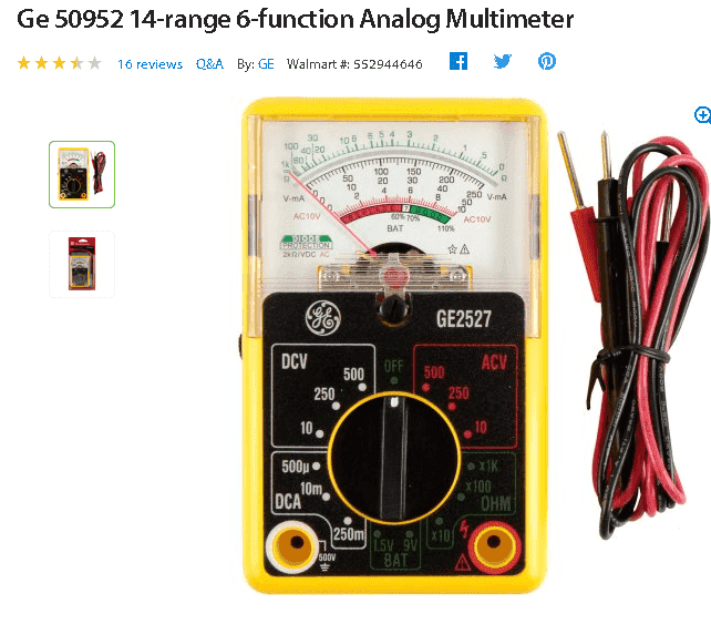

I was rewiring some bodged kitchen lights today, which are in two circuits switched by separate switches in the same box. Despite disconnecting the second switch from the power, my voltage stick still registered a beep (even with wires well away from the live ones). I guess this is a ghost voltage as the two switch wires run close together in the wall.
My Fluke 87V is sadly lacking a LoZ feature. I’d rather not buy another meter, or the very expensive Fluke stray voltage eliminator. Is there a handy trick anyone knows for ‘making’ a LoZ feature?

A small 120 volt light bulb would work but you run out of hands to hold things.
I really recommend for most house and car work :
El Cheapo Analog Meter , about ten bucks at Walmart sometimes eight
i solder into it some nice ten or fifteen foot long leads , that makes it way more handy. I can set it on the floor under my stepladder and work in a ceiling fixture without fear of dropping the meter.
And when it gets blown up i haven't wrecked a $200 Fluke.
as you see it's only 2Kohms per volt
Save the Fluke for when you need precision is my advice.

I do have one of those somewhere - it has a useful 1.5V and 9V battery test feature, no doubt a kind of LoZ in itself.
The Fluke has an input impedance of, I think, 10 Mohm for voltage measurements. I’m curious about the 2kohm/volt rating - what does it mean and what overall input impedance does it imply?
Really it means full scale deflection is about half a milliamp.
Multiply volts scale selected by 2K and that's its impedance, nearly all resistive..
On 10 volt scale it's 20Kohms
on 250 volt scale it's 500Kohms
on 500 volt scale it's 1 megohm

Find it, open it up and solder some good quality test prod wire into each socket, plenty long. I use alligator clips with boots on mine. I can always grab a nail in the alligator clip for a prod.

Ah, so it’s related to the range switch position.
Odd that I have to dig out my old cheapo meter to step in for the fancy Fluke. The lack of LoZ is very annoying, as it’s useful for this problem as well as discharging capacitors. Also annoying is the default switch to AC current measurement, which causes brief consternation and puzzlement nearly every time I use it.
