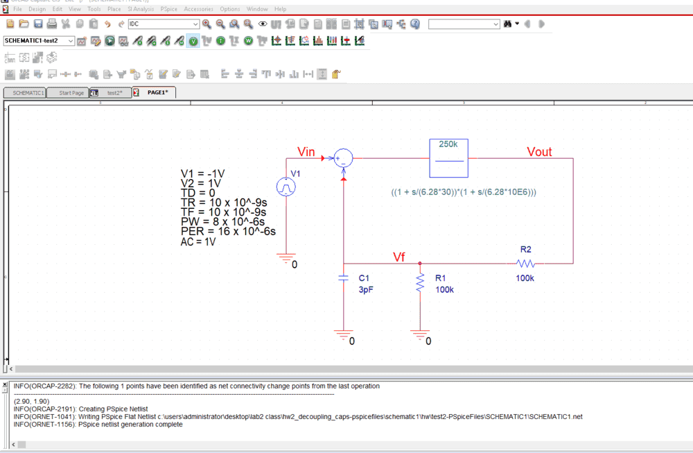

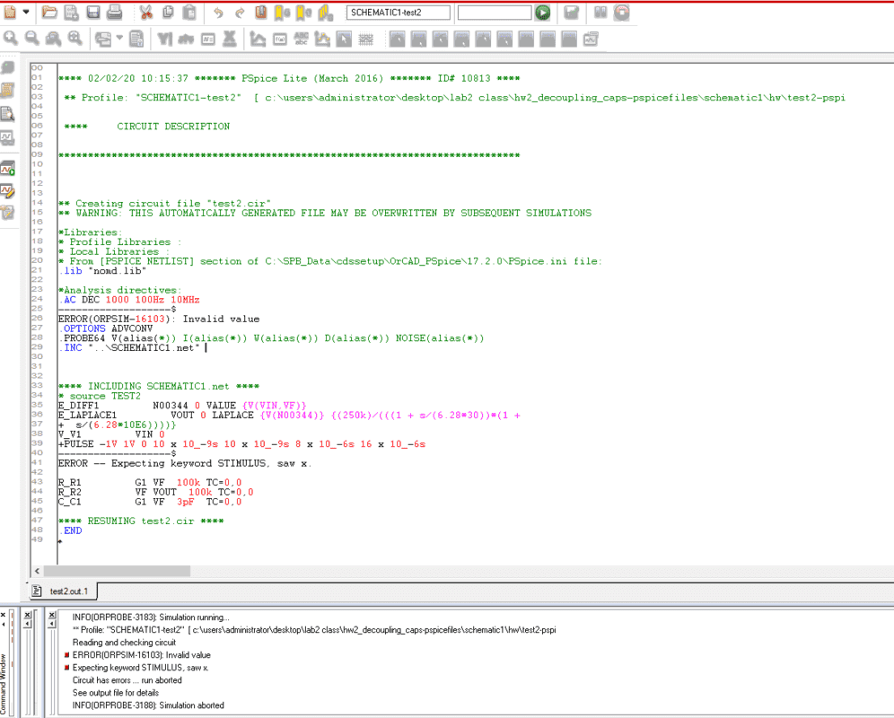

i am trying to simulate this pspice graph. i keep getting these errors. i can not figure out how to fix.. please help

Can you say more about what you are trying to simulate, and what errors you are getting? Thanks.
Looks like no connection between signal Vf and the top wire of C1.

I question the directive line; .AC DEC 1000 100Hz 10MHz
Units should not be included in values.
In standard spice, milli is; m = M = 1e-3, while MEG = 1e6.
Try; .AC DEC 1000 100 10MEG
The second error is probably due to the use of "x" for multiply rather than "*".
Rather than "10x10^-9s" You may need to use something more like "10e-9*s"
