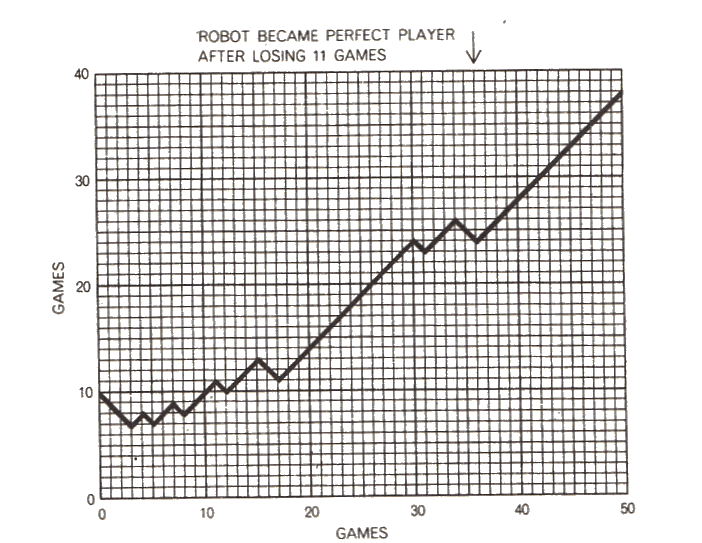

See Martin Gardner's A matchbox game learning machine Chapter 35 in The Colossal Book of Mathematics where he describes HER, a Hexapawn Educatable Robot, built from 28 matchboxes to play the game of Hexapawn. I have uploaded the pages in the PDF below. See the graph - starting from nothing it took the matchboxes 36 games, including 11 defeats, to "work out" how to play a perfect game.
You could probably make a matchbox equivalent to play your number guessing game.
