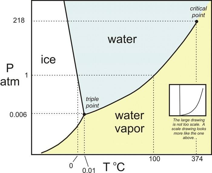

So, I did look into this some more and I guess I haven't looked at a phase diagram in a while:
As you can see, if you can get water below 0.006 ATM, it will boil, then freeze, then just sublimate. But a car engine doesn't produce that much vacuum (though I will say, I didn't know anyone ever harnessed the intake vacuum for anything...).
