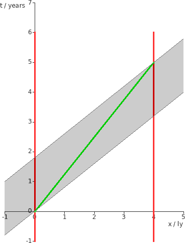

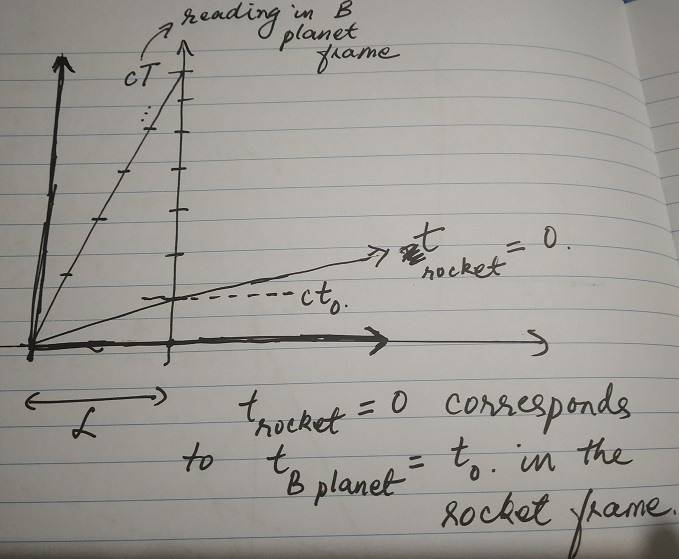

I can do it. Planets A and B are at rest relative to each other and separated from each other. T is a traveler that passes A on his way towards B. When T passes A he sets his clock to zero and notes that A's clock also reads zero. Prior to this happening the occupants of A and B have synchronized their clocks, so a clock at B also reads zero, according to the occupants of both A and B, when T passes A.
But T will not agree that the clock on B reads zero when he passes A. Instead, he will observe that the clock on B is well ahead of the clock on A. This effect is called the relativity of simultaneity.
You cannot understand the symmetry of time dilation (each observes the other's clocks running slow) without also understanding the relativity of simultaneity. This is the stumbling block to understanding the twin paradox.

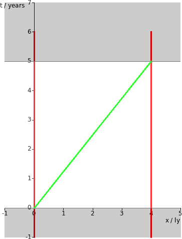

There are several acceleration-free ways of stating the problem. Here’s one, described using a frame in which the Earth is at rest:
We start with spaceship A somewhere to the left of the earth, moving right at speed v relative to earth, and spaceship B somewhere farther to the right of earth, moving left at speed v relative to earth. A will pass by Earth and then eventually meet B moving in the opposite direction; and then B will continue on past the Earth while A sails off into the distance.
As A passed Earth we zero a clock on Earth and on ship A; this works because A and Earth are at the same place at the same time. Later A passes B and and as they pass the clock on B is set to ##T_1##, the time on A’s clock as they pass one another; again this works because A and B are colocated. B’s clock continues ticking as B approaches earth. The time on B’s clock as B passes Earth will be the total time along the outbound leg and the inbound leg; it’s the time that would be registered by a hypothetical acceleration-tolerant clock that was transferred from A to B as they passed one another.
When we compare B’s clock and the Earth clock as they pass, we will find that more time passed on Earth than on the two legs of the round trip.

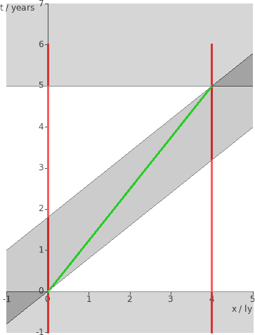

  • #59
Ibix said:
You can analyse the trip in any frame you like. However, naively patching together the inertial frames associated with inertial segments of a worldline does not produce a valid frame - the result has gaps and overlaps.
Here's a graphical explanation of that. First, here's a spacetime diagram drawn in the frame of the planets. The red lines are the two planets (the left hand one is the distant planet, the right hand one is Earth), and the green line shows the twin traveling from one to the other.
I've shaded in the regions of spacetime that this frame regards as "before" and "after" the journey. Below, I've drawn the same diagram, but this time I have shaded the region of spacetime that the traveling twin's inertial frame regards as "during" the journey. This region is slanted on this diagram, because it is using a different frame's simultaneity criterion.
So these are the three regions of spacetime you are trying to patch together to make a single frame:
As you can see, the result doesn't cover all of spacetime, and does double-cover some regions (darker shaded). So the problem you have with this approach is that you've failed to count the time elapsed on Earth for the bit of the right hand red line that doesn't lie in a shaded region. That's why you are predicting that the Earth twin will be younger - you are only counting a part of their actual lifetime.
It is, of course, possible to construct non-inertial frames in a non-naive manner so that they do cover all the relevant regions. My favourite is Dolby and Gull, but plenty of others are possible. Note that the maths for using such non-inertial frames is significantly more complicated - for a start, the expression for the interval will not be so trivial.
  • #60
#1 - and I suppose that the frame for an object as it progresses through time has to cover all of spacetime, that is its now line has to sweep out all of spacetime? (that makes sense, but nothing is obvious to me in this game).
#2 - I do believe that the Lincoln vid was while not technically wrong it was misleading, on his insistence that acceleration did not account for the distinction in the twins perspectives. Yes? No? Or, maybe it is technically wrong.
#3 - I just re-watched a Ted vid on the subject which I do think is technically wrong in that it says that the traveling twin sees the time passing slowly for the stationary twin on the outbound flight and quickly on the inbound flight. Note that both these vids are relatively recent and have 1+ million views, no mean achievement for a physics vid I think. Yes? No?
