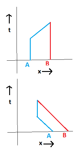

So A and B (not twins) look at each other from 20 light year distance, and each looks 20 years younger than himself, so each considers the other to be 20 years younger.
When A is 40, he embarks on a trip to B at .8c, when B appears to be 20. During the 15 years of the trip (ship clock), B's age accelerates to 3x normal, so B is 45 years older, or 65 (20 + 45) at trip end, and A is 55 (40 + 15).
From B's perspective, A looks 20 years younger until B's apparent departure at A's age 60 when A appears 40. B then appears to age 3x normal for the 5 year duration of the trip. At arrival 5 years later, A has aged 15 years during the 5 apparent traveling years, and B has aged 5 more, so they're 55 and 65 respectively.
All nice and consistent, symmetrical even, and no white or double grey areas. No discontinuities of anybody's age just because they're not present at some acceleration event. The rule is: for any observer, all of local spacetime is foliated by his past light cone. It lacks commutativity: If A is 40, B is 20 to A, but A is not 40 to 20 year old B, but that jives with reality. B cannot communicate with A anyway without the 40 year round trip lag, just like talking to the Mars rover.

  • #66
In the twin paradox there is a time in which A and B are at the same age at the same location (Earth). That's the starting point. This scenario has B already on the distant planet before he is joined by A. Obviously, if the two traveled together to the planet, there would be no difference in their ages throughout the trip and thereafter.
Here is my simple thought: If the two travel separately, assuming that the two trips are identical in terms of accelerations and velocities, when the twins meet on the distant planet, they will have zero age difference relative to each other. The relative aging process should be time-invariant and cannot depend on departure delays.
@Will Flannery's mistake is in A's reasoning. Suppose we start with a triplet instead of twins. Sibling C stays on the Earth, B leaves first and is followed by A. When A and C receive word that B has reached his destination safely, they know that B is younger than both of them. When A reaches his destination safely, he knows that he has aged relative to C exactly the same way that B has. Therefore, he expects to see B as aged as he is but younger than C. Similarly, when he lands on the planet, B knows that he is younger than A and C and that he will age at the same rate as them thereafter. Thus, when B is joined by A on the planet, he expects him to be as aged as he is, with both of them younger than C.

That is not correct. For a counterexample, consider me sitting at rest in my chair right now: It is very convenient to describe myself as at rest, choosing a frame in which my coordinate velocity and acceleration is zero. Yet that frame is not inertial; the proper acceleration is non-zero.

I'll take a stab at explaining this through spacetime diagrams. Other members can feel free to correct if there are some things I got wrong.
The thick axes correspond to ##A##'s planet's frame, and the orthogonal axes on the right are those of ##B##'s planet. The above spacetime diagram is from ##B##'s perspective. The origin clocks on both planets are synchronized. But suddenly ##A## jumps into the rocket, and you can see that ##t=0## for the rocket coincides with ##t=t_0## for the planet ##B## origin clock in the rocket frame. You see that the time elapsed in the journey in ##B##'s frame is ##T##.
The demarcations on the time axes represent "ticks" on the clocks in the respective frames. ##B## sees that the rocket's time axis demarcations are larger, i.e. the clock ticks in the rocket take longer, i.e. ##B## will say that fewer ticks were counted by the rocket frame clock.
When ##A## stops on planet ##B##, even though ##A##'s clock switches its ticking rate to what ##B##'s clock's ticking rate is, that still doesn't change the fact that fewer ticks were counted by ##A##'s clock so far from ##B##'s planet's perspective, which is where they're finally comparing times.
Why can't we reverse this argument and switch roles? Let's look at another ST diagram from the rocket's perspective:
Remember we'd concluded that ##t=0## for the rocket coincides with ##t=t_0## for the planet ##B## origin clock? This is what we're trying to account for above and that's why planet ##B##'s spacetime diagram is shifted below. So now ##t_0## of ##B## planet's origin clock coincides with ##0## on the rocket clock, which is what we want as this ST diagram is from the rocket frame perspective.
In terms of aging, ##B## has a headstart of ##t_{\text{extra}}## on ##A##. So even though ##B##'s clock ticks slower from ##A##'s perspective, some time has already elapsed on ##B##'s clock which makes up for it.
