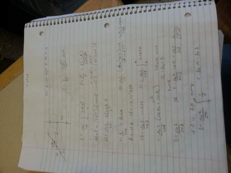

Wire Ia and wire Ib are infinitely long and perpendicular to each other, separated by distance d. Wire a has current Ia and the direction of current is into the page. Wire b has current Ib and the direction of current is straight up. What is the force per length of Ia on Ib and force per length of Ib on Ia?
B=[itex]μ_{0}I/2πr[/itex]
Magnetic field at a specific location is a function of distance from the source of the field (current).
F=IdsχB
The image shows my attempt at finding the magnetic field on wire b due to wire a. This problem has been eating away at me for over a week now - it is how it is worded. I know that due to the right hand rule.
My initial attempt shown in image 2 which arrives at the form of the Biot-Savart shown above. My idea was that distance ranges from d to infinity. The distance between the two wires will never be less than d (separation distance at the perpendicular) and can increase to infinity. Also, I would imagine that the force acting on a location, say, s above the perpendicular point on Ib would cancel out the force acting at distance s below the point. When I try to take the integral, though, it is not convergent.
Logic tells me there would be a torque which would act to align the two currents.
There is a piece of this I am overlooking though
Thanks!

Did you draw wire 1 as going into the page? Doesn't look like it.
Draw an x-y coord. system with wire 1 going into the page at the origin. Then draw wire 2 running in the y direction a distance d to the right of the y axis. Current in wire 2 is along the +y direction.
Now draw an Amperian circle of the B field set up by wire 1. It will intersect wire 2 in 2 places, above & below the x axis. What is the direction of the B field at those two points? Taking for the moment just the half of wire 2 for which y > 0, you can relate the magnitude and direction of B as a function of y: B = B (y).
Now take an element of wire 2 = dy j and form the force d F = i1 d l x B and integrate d F from y = 0 to y = ∞. That is the total force on wire 2 above the x axis. Then do the same for the half below the x axis.
What is the result? A net force on wire 2? A net torque on it, & if so about what axis?

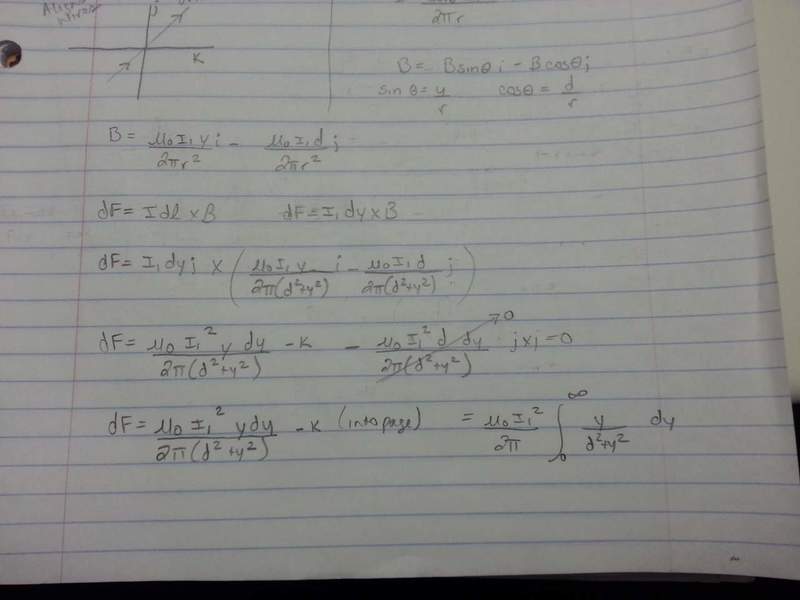

I have drawn the image as you depicted, and I see the B field, and was able to relate the angle the B field was going off at (90 degrees to the hypotenuse of an imposed triangle in the clockwise direction). I know it seems silly, but I am having an issue relating magnitude and direction to y
If I draw a triangle and make the hypotenuse r, I know that as y increases, r increases, and B decreases. When y=0, θ=0. When y=∞, θ=90 as per my attached diagram. Force will be 0 at the x-axis , into the page for +y, and out of the page for -y.
My attempt at the force can be seen on the lower right. I'm having an issue distinguishing between d and r sometimes as well and am not very confident in my answer.
The effect of wire 2 on wire 1 is essentially the same, except the forces are pointing the opposite direction. The two wires will want to rotate about the x-axis and align themselves.
This is a whole lot better!
You should retain vector math, not go off into scalars the way you did though. And take note that it's dF , not F for the force on an element dy.
All correct.
Yes, once you get the force of wire a on wire b, you can just exchange coordinates so as to make wire b be wire a and vice-versa. Or believe in Sir Isaac!
How about this: B = Bsinθ i - Bcosθ j, i, j unit vectors
sinθ = y/r, cosθ = d/r
B = μI/2πr as you stated but r = √(d2 + y2)
dl = dy j
I'm using bold type for vectors.
Now can you form dF = Idl x B and integrate from y = 0 to y = ∞?
(You have correctly deduced that dF = 0 for y = 0 and for y = ∞. For extra credit, where along y is dF maximum? :smile: )

You have been a tremendous help so far, I genuinely appreciate it as vector calculus and trig have never been strong points of mine
I worked through the problem keeping it in vector form but I don't get a convergent integral. I got dF to be in the -k direction which is into the page and what I would expect.
As per the extra credit, my initial inkling would be where θ=45 degrees, but I'll certainly investigate further once I figure out the force!
- k direction is correct. What was your integral?
That happens to be correct! If you get the right integral you can easily show that that is so (y = d).

The work is shown in the image in my last post, but essentially I ended up with
dF=μ0I12ydy/2∏(d2+y2) -k
dyj crossed with the j component of the magnetic field zeros out, leaving only the -k component

That is right and that is the integral I got. And now I see that you're right, the integral does not converge if taken to ∞ as the upper limit. :redface:
I notice belatedly the problem asks somewhat cryptically for the "force per length of Ia on Ib" and vice-versa. So for that you would not integrate but give the answer as just dF which is finite everywhere and goes to zero at infinity. Somewhat of a strangely posed problem, seemsd to me.
Anyway, I agree with everything you did at this point.
EDIT: another thought - maybe by "per unit length" means divide the integrand by y. Then your integral would be ~ dy/(y2 + d2) = (1/d)tan-1y/d which evaluates to π/2d if taken from 0 to ∞.
I was able to leave it in the integral form and it was acceptable. Thank you for your help!
