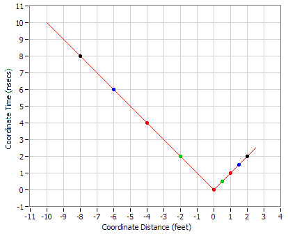

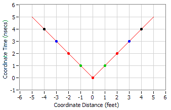

Here's a spacetime diagram depicting your scenario for frame F. Note the pairs of events with the same color:
Now I transform the coordinates of the events to frame F' moving at 0.6c with respect to frame F:
Now you can see that none of the pairs of same-colored simultaneous events from frame F are simultaneous in frame F' but there are other pairs of events that are simultaneous in frame F' but they won't be simultaneous if frame F.
For example, in frame F' (the bottom diagram), the green event on the left beam is simultaneous with the black event on the right beam but these two events are not simultaneous in frame F.
Does that help?
