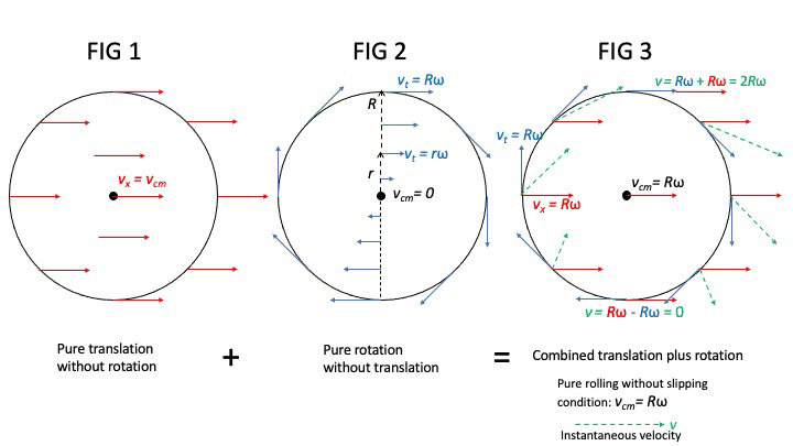

Suppose a sphere is rolling on horizontal surface. The point of contact is the instantaneous center of rotation. It's velocity momentarily is zero. So in a time dt it'll stay where it is.
However during this time dt the point next to this contact point at its right side will move forward and down, thus after time dt we will have two points in contact with the horizontal surface. Which is wrong.
What's wrong with my approach?

You are allowing the positions of the points to change in time dt, but not their velocities. That means you are modelling their instantaneous accelerations as zero, which is not consistent with a model of a rotating object.

More fundamentally, ##dt## is either a non-zero time interval (in which case nothing is constant) or it's a differential (in which case it is not a time interval).

No, it won't. It will, for example, rotate through an angle ##d\theta##.

But ##dr## is only zero if ##v## is zero for the whole time period ##dt##. So you are saying that the acceleration is zero - which I hope you know is false. If the contact point has non-zero velocity after the time period, how did it get that way if the acceleration is zero?
The point is that if you are using ##dt## to mean a small time interval then ##v## is actually ##v(t)## and not a constant. If, instead, you are meaning that ##v## is the instantaneous velocity then ##dt## is not a time period. Rather, it is the limit as the time period goes to zero, which is a mathematical device that allows you to deal with an instant of zero duration without having to divide by zero, as others have explained in more detail.
