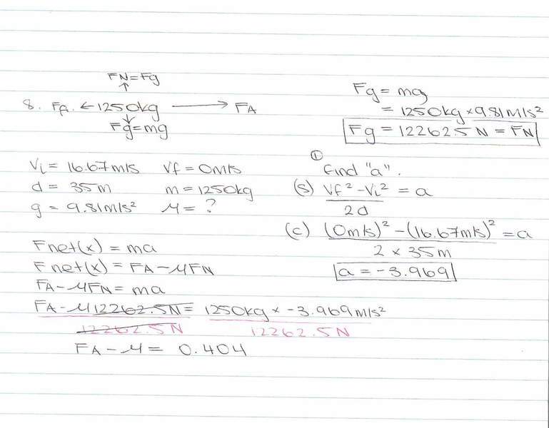

So I've been busting my head for the past 2 days trying to figure out what I was doing wrong and I just can't. I have a whole bunch of these types of questions and can't solve any of them.
My own equations and reasoning make sense to "me" but don't lead me to the right answer. I am positive I'm overlooking some huge thing. Please help!
a 1250kg car traveling at 16.67m/s comes to a sudden stop in 35m. Find the coefficient of friction acting on the brakes.
Vi: 16.67m/s
Vf: 0m/s
m: 1250kg
a: (found), -3.969
g: 9.81m/s2
d: 35m
Fnet(x)=ma
Fnet(x)= Fa-[itex]\mu[/itex]Fn
Fa-[itex]\mu[/itex]Fn = ma
Going insane! See attached doc...
Thanks again guys!

What does Fa stand for?
Hi :biggrin: Applied force.
Hi Apollinaria. Besides the force of friction, is there another applied force that acts horizontally? If so, can you describe it?
There's nothing else. The wording of the problem I posted is exactly as is in the worksheet I was given. Unless you mean the a(deceleration)... :rolleyes:
If friction is the only force that acts horizontally, why did you include a vector labeled FA in your drawing that acts in the direction of motion?

At first glance I don't think you have enough information to answer that but ... perhaps they meant the coefficient of friction acting on the tyres (or perhaps that's the same as the brakes but I can't think why)...
Anyway you could calculate the stopping force from the energy balance..
work = Fa x distance = 0.5 x mass x V2
Fa = 0.5 x mass x V2/distance
The vertical force on the tyres is just
Fg= Mass x g
So the ratio is
= (0.5 x mass x V2)/(mass x g x distance)
mass cancels
= (0.5 x 16.672)/(9.8 x 35)
= 139/343
= 0.405
Have edited this to get the ratio the right way up!
If that's right Yippiee. If not I'm sorry but it's been a long day.
Because I am struggling with this dynamics unit. So you're saying I can exclude the FA?
How would I know if there is an FA? Only when it is stated?

It's important to know exactly what forces are acting for a specific problem. When you draw a force diagram (free body diagram) you should only include forces that actually act on the object. A good thing to do: whenever you draw a force on a diagram, ask yourself where that force is coming from. If you can't answer that for a given force, then you should question whether that force should be there.
When the car is breaking to a halt, only the force of friction is acting in the horizontal direction (we are neglecting air resistance).

Thank you so so so much for explaining this.
I thought there was always an applied force when there was a force of friction; as in, they come in pairs. Kind of like Fg and Fn do when an object is resting on something (but not when it is in the air).
Thanks again for bringing this to my attention. I will now think many times before drawing :smile:
