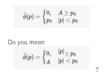

- Homework Statement
- Zettili Quantum, 3rd Edition, Exercise 1.39 (page 89)
Part (a): Find the Fourier transform ##\psi(x)## of $$\tilde{\phi}(p)=\begin{cases}0,&\left|p\right|\geq p_{0}\\A&\left|p\right|<p_{0}\end{cases}$$
Part (b): Find A so that ##\psi(x)## is normalised.
Part (c): Estimate the uncertainties ##\Delta p## and ##\Delta x## and then verify that ##\Delta x\Delta p## satisfies Heisenberg's uncertainty relation.
