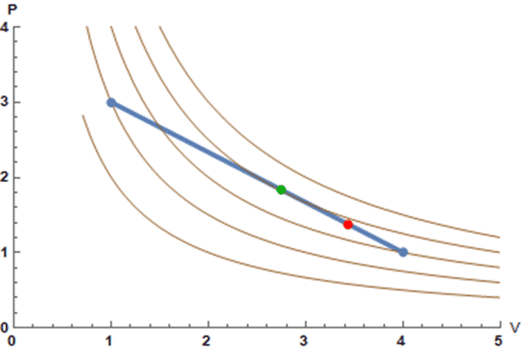

In the diagram below, the blue line represents the linear process ##P = a - bV## and the red lines are various adiabatic curves ##PV^\gamma = C ## for ##\gamma = 5/3##.
The green dot is the point of maximum temperature for the linear process and the red dot is the point that is tangent to an adiabat. Heat is being added to the gas for points on the linear process that are to the left of the red dot. Heat is being removed for points to the right of the red dot.

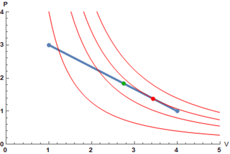

Here's a graph showing isotherms instead of adiabats.

I think your approach and @Chestermiller's approach are both correct, but they represent different interpretations of the word "heating" in the problem statement. For you, heating is interpreted as heat being added to the gas. For Chestermiller, heating is interpreted as increasing the temperature of the gas. The answer of -1.96 for the energy-change ratio corresponds to Chestermiller's interpretation.
As you go from the green dot to the red dot on the blue line in the previous graph, heat is being added to the gas while the temperature is dropping.

But the same adiabat doesn’t pass through the initial and final states, let alone not being linear wrt P vs V
That's right.
But for an infinitesimal step of the linear process centered at the red dot of the graph, there is no difference between moving along the linear process or moving along the adiabat that is tangent to the blue process at the red dot. So, as you pass through the red dot along the blue process, heat is neither being added to the gas nor removed from the gas. So, the red dot separates the "heating" portion of the linear process from the "cooling" portion of the linear process if "heating" is interpreted as "adding heat".
