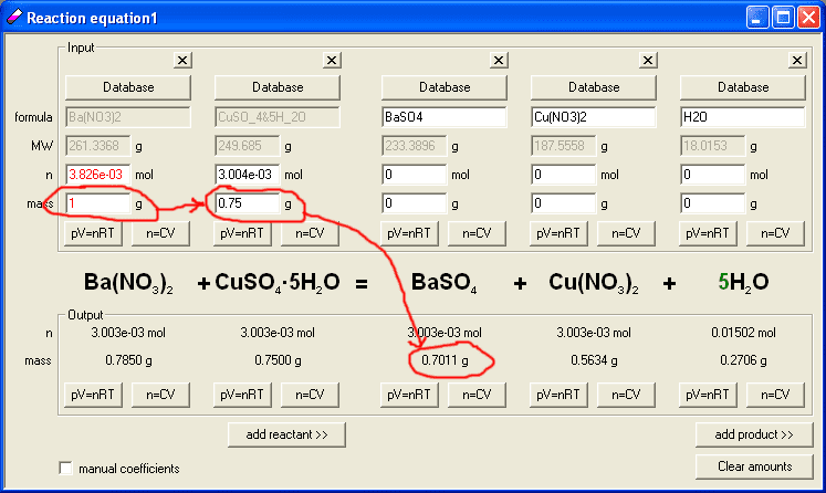

Any ideas what the inherent flaw in this experiment is?
In the lab (actual lab), we combined copper(II) sulfate pentahydrate with barium nitrate to form barium sulfate (precipitate). Every group got a 115% or higher yield than stoichiometry would predict.
Ba(NO3)2 + CuSO4 5H2O --> Cu(NO3)2 + BaSO4 + 5H2O
Mass of barium nitrate: 1 g
Mass of copper(II sulfate pentahydrate) 0.75 g
Moles of copper(II) sulfate pentahydrate: 0.75g/249.71g/mol = 0.00300 mol
Moles of barium nitrate: 1g/261.35 g/mol = 0.00383 mol
The limiting reagent is thus copper(II) sulfate pentahydrate, and because of the 1:1 mole ratio, 0.00300 mol of barium sulfate should be produced.
0.00300 mol x 233.39 g/mol = 0.700g
However, all my students recorded at least 0.8 g... I'm very confused. It must have something to do with the water/pentahydrate?? But I can't see that mathematically if I try to remove the water completely. Any ideas what the flaw in this experiment is?
Your calculations are correct (I got 0.7011g, using exact values of molar masses):
Two things I can think of.
First, copper sulfate pentahydrate doesn't have an exact composition - exact number of water molecules depends on the temperature, humidity and the sample history. If memory serves me well it is quite possible that the sulfate you were using was not pentahydrate, but something like four-and-half-hydrate.
Second, how were you drying the barium sulfate? In analytical chemistry we roast it to the constant mass in the 600-800°C, lower temperatures don't guarantee it will be completely dry. If it contains water its mass will be higher than expected.
Well it's only high school so we let them air dry overnight (and it's a low humidity climate). It seemed very dry and flaked easily. Combined with the idea that it may not all be pentahydrate could possibly account for it.

Virogen said:
Also, what program did you use to check these calculations? It looks massively helpful!
[blatant ad mode]
. It is massively helpful by design :wink:
You may also want to check this quiz preparation story - there is more to the program than is apparent from the screenshot, and there are more helpful programs (all with 30-days free trial versions).
