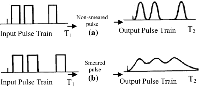

This is not an adequate answer, but it may help. Pulses smear together when they are too close together and conditions aren't perfect. The imperfections set a bandwidth limit to the system.

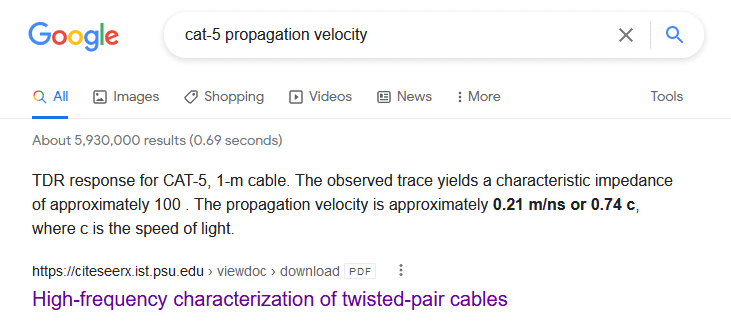

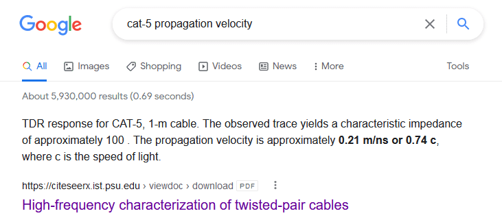

DaveE said:
Electrical cables will still carry signals at something like 1/3 of the speed of light
Not the cables I use...
Take for example your vanilla Ethernet cable...

artis said:
@fog37 Let me try to jump in a bit here.
First of all from what I know the typical electrical signal propagation velocity for a copper cable is about 2/3 or 0.7c , but as others already said it's not about the speed of light (EM) within the conductor but about the frequency.
Actually if you think about it, all EM waves travel at c in vacuum , even the VLF ones used for submarine communications that are in tens to hundreds of Hz range (audible frequency bass range)
But as you probably already know they have very small bandwidth but it's not because of their propagation velocity rather simply because of the low frequency.
So here would be a rule of thumb
1) Propagation velocity - latency (time it takes for your message/signal to arrive, somewhat like the speed of a post pigeon)
2) Bandwidth - amount of information one can send in a fixed time. (sort of like how many pigeons you can make fly at the same time)
The reason I think higher frequency allows for more bandwidth is simple, frequency is just the number of times the EM wave makes a full cycle within a given time period , usually taken as one second.
So the more times your sine wave goes "up and down" within that one second the more cycles you have for encoding information.
A simple analogy would be a light house trying to send info with Morse code.
It can send the code by using a maximum of 1 cycle per second, that would be switching on/off no faster than once a second so adding the delays for the code to be meaningful that would mean a short bit of code within 10 seconds, or it could use say a laser and switch the laser on/off 1 billion times a second, again add the delays and now you can send a whole book within those 10 seconds.
The rule is that the higher in frequency you go the more times you can switch between on/off within a second and the more information therefore you can encode within that time.
So IIRC this is why say a 5Mhz bandwidth for an optical (visible range) can hold more info than the same 5Mhz band at Microwave frequencies if identical modulation method is compared.This is the reason I think why they went from 4G to 5G, more bandwidth in a smaller frequency range, more channels available etc.
Thanks!
