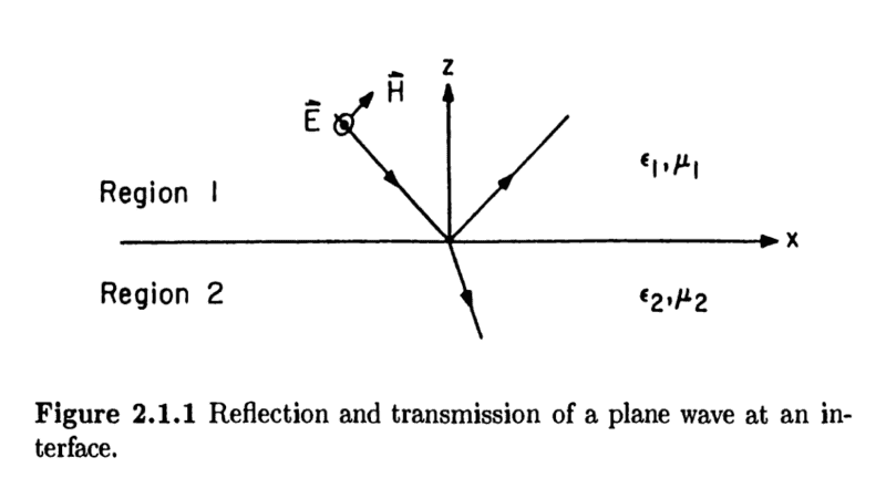

Ok. Well in this case, can I suggest you a different reference? Have a look at chapter 2 in Weng Cho Chew's "Waves and Fields in Inhomogeneous Media" by IEEE Press. It has plenty of detail on solutions for the TE and TM cases in much simpler form that is still completely general, and does apply to lossy media. The treatment there is farily standard, and I even started to derive it here myself, but then I thought you would rather have a proper reference than "someone on PF told me...".
Here are the extracts from that chapter. We are looking at the geometry as in Fig. attached. Here it is the TE case. The y-polarized electric field is subject to:
##\left[\partial_{xx}+\mu\partial_z \mu^{-1}\partial_z+\omega^2\mu\epsilon\right]E_y=0## (Eq. 1)
in both domains. Note that ##\mu## (full permeability) and ##\epsilon## (full permittivity) here can be complex. ##\omega## is the angular frequency. Suitable solutions are:
##E_y=e_y\left(z\right)\exp\left(\pm i k_x x \right)##
For the reflection/refraction problem, i.e. the wave is incident from medium 1 we have
##e_{1y}=e_0 \exp\left(-i k_{1z} z\right)+R^{TE}e_0 \exp\left(+i k_{1z} z\right)##
##e_{2y}=T^{TE}e_0 \exp\left(-i k_{2z} z\right)##
In both domains the x-component of the wavevector has to be the same ##k_{1x}=k_{2x}=k_x## (follows from interface conditions for Maxwell Equations). Before continuing let's understand what these wavevectors are. Going back to Eq. (1) we see that:
##k_x^2+k_{1z}^2=\omega^2\epsilon_1\mu_1##
##k_x^2+k_{2z}^2=\omega^2\epsilon_2\mu_2##
One can easily convince oneself that if ##k_x=k_1\cos\theta_i## and ##k_{1z}=-k_1\sin\theta_i##, where ##k_1^2=\omega^2\epsilon_1\mu_1## then ##\theta_i## is the incidence angle. Note that relating ##k_x## and ##k_{1z}## through ##\theta_i## is merely the consequence of equations above. We then add the interpretation of the incidence angle on top. Also, it follows that the reflection angle is the same as incidence angle since both waves are in the same domain.
One may ask wether ##\theta_i## has to be real-valued here. In general it does not, however if we do want to talk about plane-waves, which can be converted into one another by simple rotation of coordinates, then it does.
For domain 2 we must introduce a different angle, which will be the refraction angle ##\theta_t##: ##k_x=k_2\cos\theta_t## and ##k_{2z}=-k_2\sin\theta_t##, where ##k_2^2=\omega^2\epsilon_2\mu_2##. It follows that ##k_x=k_1\cos\theta_i=k_2\cos\theta_t##. Which is general could mean that ##\theta_t## is complex-valued. This indeed is a modification of the Snell's law. You will get attenuation of waves in the direction that is different to propagation direction=evanescent waves. Can you handle this in Blender?
By the way. In the non-magnetic case ##\mu_{1,2}=\mu_0## and ##\epsilon_{1,2}=\epsilon_0 n^2_{1,2}##, where ##n## is complex refractive index. We can do the TM case next.

Sorry. This is why proper references are good. I mislabeled the angles.
is sufficient to relate one component of the wavevector to ##sin##, and another to ##cos##. Which way you do it is a matter of choice, but the convention in optics is to declare the incidence angle as ##k_x=k_1\sin\theta_i## and ##k_{1z}=-k_1\cos\theta_i## . The reflection angle still stays the same as the incidence angle. The continuity of the tangential electric field leads to:
##k_x=k_1\sin\theta_i=k_2\sin\theta_t##. Sorry for confusion. The incidence and transmission angle stuff is not in the book actually. The author only talks about the wavevector components, but this is enough.

Sorry, that's a bit too involved for me. To describe this problem properly you need a ton parameters, which would take too much time. If you are digging deep into Blender, I guess you must be ok with Python? I wrote a simple script that visualizes the plane wave scattering at the interface of the two media. Hopefully it will help.
Regarding the imaginary part of ##k_x##. You can have it zero, i.e. you can make ##k_x## fully real even in lossy medium. The way to do this is to have complex-valued angle of incidence. The problem is whether this will represent anything physical. My thinking was that the incident wave must be a conventional plane wave that, which would be given by:
##\exp\left(-i\omega t+i k z'\right)##
where ##z'## is the axis of propagation. To make this into an incident wave we simply rotate this solution by angle ##\theta_i##, which gives:
##\exp\left(-i\omega t- i k \sin\theta_i x + i k \cos\theta_i z\right)##

Hmm... let's see if I can understand this correctly
##\boldsymbol{E}=\boldsymbol{E}_0e^{i\left(\hat{k}\boldsymbol{r}\cdot\boldsymbol{s}-\omega{t}\right)}##, where ##\hat{k}=k_0(n+i\kappa)##. A different notation for the complex refractive index is used here.
##\boldsymbol{E}=\boldsymbol{E}_0e^{-k_0\kappa\boldsymbol{r}\cdot\boldsymbol{s}}e^{i\left(k_0n\boldsymbol{r}\cdot\boldsymbol{s}-\omega{t}\right)}##
##r\cdot{s}## would be ##x\sin\theta+z\cos\theta##, right?
So then the exponent terms become
##-k_0\kappa(x\sin\theta+z\cos\theta)## and ##i\left(k_0n(x\sin\theta+z\cos\theta)-\omega{t}\right)##
I assume this is where the generalization comes in, where it seems the imaginary part of two mediums' refractive indices are related by ##\kappa_1\sin\theta_1=\kappa_2\sin\theta_2##. Although, that doesn't make sense because it appears that the angles should be the same within both of the exponentials. Instead, is it correct to combine the exponentials such that ##(n_1+i\kappa_1)\sin\theta_1=(n_2+i\kappa_2)\sin\theta_2##?
Cryo, this is essentially what you have shown the derivation for, is that correct?
