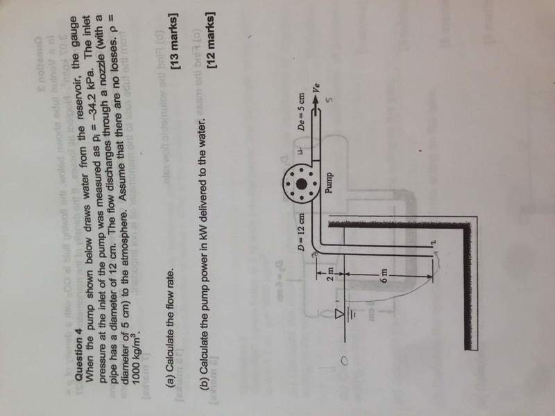

Hi, am having a few problems applying bernoulli's equation when an electric pump is involved. I have attached a picture of the question. I understand how to apply bernoullis for venturi and pitot tubes but when it involves work being done on the system eg. a water pump, fan exhaust I don't know where to start.
  • Photo of a printed exam question (Question 4) with a diagram of a pump drawing water from a reservoir: pump inlet pipe D = 12 cm, outlet pipe De = 5 cm with arrow labelled Ve, heights 2 m and 6 m marked, and a pump labelled Pump.
