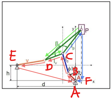

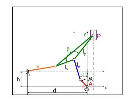

Hi, I'm trying to finish this assignment and I'm not completely sure how to proceed. Should I first create the constraint equations, then the kinematics to get the derivatives for velocities and accelerations, followed by the Lagrange equation? I'm comfortable with the algorithms, but I'm unsure about how to start, as I haven't done this in at least two years. Also, I'm not sure what max ∣RA∣ means here, but I suppose it's the length of the shoulder Rc starting from point A.
Edit: The max RA might be more likely the reaction force at A.
I don't know what ##\mathrm{max}\left| RA \right|## is either. It's hard to optimize something you don't know what is. I believe it might be the length of the red segment but it's impossible to know for sure.
The problem statement doesn't give enough information. Maybe there is an additional context that was given in class?

Assuming that minimizing the reaction ##R## at point ##A## is the objective, I think this is how I'd try to solve the problem.
  1. Find the reactions at ##A## for a general mechanism with the given rotational speed ##\omega_{12}## of the red bar, given densities ##\rho## and arbitrary sizes for the different elements. That is, use all the variables necessary to describe the mechanism.
  2. Limit the possible options to those where the piston stroke takes the value given in the statement. ##y_{Pmax}-y_{Pmin}=L_{yP}##. I believe ##y_{Pmax}## and ##y_{Pmin}## can be found through derivation.
  3. Use an optimization algorithm to minimize the reaction ##R## at point ##A## for the viable possibilities found as described in the previous point. You'll have to juggle many variables that define the position of the characteristic points of each element.
That'd be my mental map to solve it. I'll confess though that's easier said than done. Right now I believe I might be able to just do the first point with some confidence. Maybe the second one as well after putting some time into it. The third one though would require me to study quite a bit.
Please, if you solve the problem post your procedure and results. I find optimization problems especially interesting.

First, I need to define all the coordinates, particularly the mass centers, as they will be used in the system's kinetic energy. Since the green segment is treated as one area, I’ll also need to derive the equation for its mass center, as it isn’t located in the middle. After that, I will find the velocities and accelerations by taking derivatives. Additionally, I’ll define the constraint equations. I'm just fighting a bit with the definition of the coordinates for the triangle.
Once all of this is established, I’ll apply it to Lagrange’s equation of mixed type, which will give me the Lagrange multipliers, ultimately leading to the desired force. After obtaining all this, I’ll implement it in Python using appropriate libraries.

The following vectors define the position of each of the important nodes.
The location of each node will have two variables defined by a position vector. For the articulated rods, you know the distance separating them and for the sliders, you know they move within the dotted line.
  • ##A## is located at the origin so ##\overrightarrow{AO}=0##.
  • ##\overrightarrow{{BA}}## is the vector starting from ##{A}## going to ##{B}## and defines the position of point ##B##. That vector is equivalent to ##\overrightarrow{BO}## because ##A## is the origin.
    I know it might seem counterintuitive to say ##\overrightarrow{BA}## instead of ##\overrightarrow{AB}## but it's done like that so that vector subtraction cancels the letters and vectors point the right way. Since addition is commutative, it makes sense to use subtraction to define the order of the letters. In the end, you can choose to call things any way you want as long as they are coherent.
    I'll recommend you use my notation so we can communicate more easily and because of the reason I previously showed.
  • ##\overrightarrow{BA}## + ##\overrightarrow{CB}## is the vector defining the position of ##C##. That's equivalent to the vector ##\overrightarrow{CO}##.
  • And so on.
To calculate the CM of any polygon (line segments or triangles) add the position vectors defining their nodes and calculate the average.
To calculate the mechanism, you see 3 loops. In each loop, the addition of the vectors is 0. That will give you the constraints. Since you have 3 loops and each of them is a 2D vector equation, you'll have 6 equations.
  • A→B→C→D→A is 0 because you come back to the same point.
  • A→B→C→P→F→A is 0 for the same reason.
  • C→P→D is 0 for the same reason.
Create as many angles for the vectors as necessary. In the triangle case, notice that the vector's angles will define its shape so they'll be related to the angle ##\beta_y## given in the exercise. If your mechanism only has one degree of freedom, by considering ##\theta_{12}## (the angular position of the red bar) known, the rest of the mechanism will be defined.
NOTE: Mechanisms sometimes have multiple solutions.
Picture's source
In a "normal" exercise where the size of each element is defined, you'd have 6 variables and 6 equations to find the position of the mechanism.
However, in this case, besides those variables, you'll have variables defining the size of each of the elements so you'll have infinite solutions because your 6 equations are not enough to constrain the system.
You're then optimizing for the solution that reduces the maximum reaction ##R## at point ##A## for the duration of a cycle.
Thank you for the reply. I'm aware of this; I just think we use a different way to apply the constraints (in terms of the number of coordinates - degrees of freedom). Well, that shouldn't change anything since yours works with vectors, so for example, the magnitude of the BA vector will obviously consist of the x and y coordinates at its points. So I have twelve constraint equations, while you have six. Which makes sense, I guess, but it's just the way we've used it so far. I'm not sure if there is a real difference; there shouldn't be, to be honest.
The thing I meant was calculating the distance from point C to P. and from C to D. I thought that I would set an angle φcp, let's say, which I would use to get to the point P as then it would be Xp = Xc+sin(φcp), same for Yp. Then on the other side, I could say that it would be Xd=Xc + sin(βv-φcp) as the beta is constant. I don't know if this makes sense. If not I'll share my iPad notes with sketch.
I'd personally define the angles the way I described in post #9 and ignore the angle ##\beta## given by the exercise.
