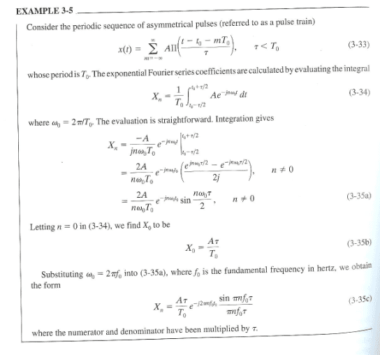

I have, (Attachment - EE HW 6 P3-6 Example), but after looking at the graph of the pulse wave (Attachment - EE HW 6 P3-6 Table) and actually reading through the integration steps a few times, it's difficult for me to understand how they found the equation for the pulse wave or if it's even needed to find the end result? It's just difficult for me with zero lecture time on the topic to try and make sense of it that's all, sorry if some questions seem foolish or irrelevant in that matter.
The right side of the equation for the pulse wave is the sum of infinitely many time-shifted rectangular pulses. [itex]\sqcap[/itex] is a symbol for the rectangle function.
That equation isn't really needed to find the Fourier series coefficients (X0), because all you have to do is integrate over one period.

Yeah cause it didn't seem to be used in the integration at all. My next question would be after examining this - if that pulse wave function doesn't effect the integration, I'm not quite sure what would change in looking at the full-rectified sine wave..
It's a different function! An integral expression for Fourier series coefficients would be different!
I didn't mean the function doesn't matter at all, I just meant you don't necessarily have to use the "train," or the actual periodic function. You just need something that is equal to the periodic function for one period, since the integral to get the Fourier series coefficients is over one period.
Take the first problem, the half-rectified sine wave, for example. First, you need a function that describes what happens in one period. In this case, it would be
[tex]x(t) = \left\{<br /> \begin{array}{ll}<br /> A\sin \omega_0 t & \mathrm{if}~0 \le t \lt T_0/2 \\<br /> 0 & \mathrm{if}~T_0/2 \le t \le T_0<br /> \end{array}<br /> \right.[/tex]where [itex]\omega_0 = 2\pi/T_0[/itex]. The coefficients Xn are given by
\begin{align*}
X_n &= \frac{1}{T_0}\int_0^{T_0} x(t)e^{-jn\omega_0 t}\,dt \\
&= \frac{1}{T_0}\left[\int_0^{T_0/2} A\sin\omega_0t\,e^{-jn\omega_0 t}\,dt+\int_{T_0/2}^{T_0} 0\,e^{-jn\omega_0 t}\,dt\right] \\
&= \frac{1}{T_0}\int_0^{T_0/2} A\sin\omega_0t\,e^{-jn\omega_0 t}\,dt
\end{align*}
I'll leave it to you to crank out the integral.
